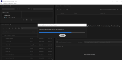

Before the updates and after, Media Enoder won't open any sequence with the Colorista effects applied.  It starts to open then hangs about 3/4 through the process. (see attached image)
I removed the Colorista and Media Encoder will open.
Also, there were no issues a week or so ago on this project with Encoder and Colorista.

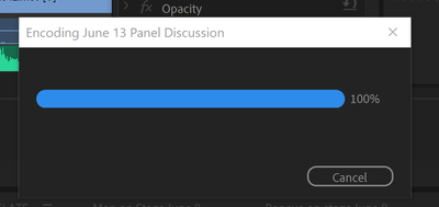

Cancel that. It gets to 100% done and just hangs.
