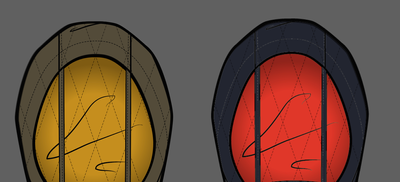

Hi there.
So I have the same round objects filled with different colors. They both have the same vector fill. I rasterized both of them. And then copy and paste them into XD. But the one on the right comes out fuzzy. They are both at 100%. I did not resize them in XD or AI. I've looked at the layers for each object and they are exactly the same. Below are my raster settings.
And here is my setting when I rasterize the object. I do set it to a  transparent background.
Below is a screenshot of both objects after they've been rasterized in AI.
And below is what they both look like after I bring them into XD.

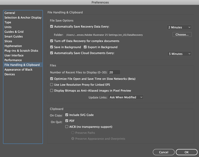

Please check if your Illustrator Preferences are set accordingly.
(The screenshot is in Dutch, but you'll get the message, I guess...)
It's the File Handling section, the part about Clipboard support:
New Here ,
Apr 21, 2021 Apr 21, 2021
Hi Peter.
Thank you for replying. Yes, my settings are the same.
