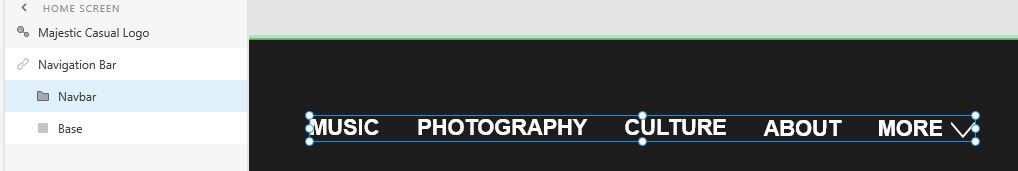

Hey all,
I recently started a new project on XD after quite some time and it's very obvious to me that a lot has changed since I last used it. Furthermore, I am trying to adding an object to a component. I read the article on how to work with components in XD (http://helpx.adobe.com/xd/help/components.html) and found the section for adding elements onto a master component would be useful to me in my case. However, I tried to apply the tips that were mentioned in that section but was not able to add the Menu Arrow onto the Navbar Links component. I have posted a few screenshots below to provide more context and detail in order to better illustrate my issue.
Going back to the article I posted the link to, there was a section towards the end of the article that discussed limitations with the latest update of XD and how to work around them. This part, in particular, caught my attention but I wasn't quite sure what it meant:
I would appreciate if you guys could help me out and point out what I'm missing here or if there is any way for me at all to add the Menu Arrow onto the Navbar Links component. It looks like something that could be done on XD and I hope I'm able to find out how to do that successfully on here. Let me know if you have any questions or if there's anything else you'd like for me to provide or clarify for you. Thanks to all who responded. I appreciate your assistance!
Best,
Abhi

Hi Kenneth,
Thanks for your response. I appreciate your help. Can you please explain how you would go about grouping the arrow and navbar links together to create a single component? I previously tried to do that by selecting all of those items at once to make a component but to no avail. Afterwards, I tried to go about combining them to form one component as detailed in my original post, but made little progress with that.
Community Beginner ,
Jun 14, 2019 Jun 14, 2019
I think I may have figured it out. What I did was go to the layers panel and held the Ctrl button to select both the menu arrow and navbar links. Once I did that, I was able to make a single group with those components. The only problem I'm facing now is that when I go back to my Assets panel, it still shows the navbar links and down arrow as two separate panels. But when I go to my Layers panel, it correctly displays it as a single component with the name of Navbar. I've added a couple of snips below for context. Let me know if you there's anything you'd like me to clarify. Thanks again for your assistance!

Hi Kenneth. Sorry for not clarifying. What I was referring to was the discrepancy between what's displayed in the Assets panel and what's displayed in the layers panel. In the layers panel, I was able to successfully group the navbar links and the down arrow to form a single component, the Navbar. As a result, I am able to see just the Navbar component on the layers panel. But when I go to the Assets panel, I don't see navbar component. Instead, I see separate components for the navbar links and the down arrow, even though I'm able to select the both components at once just like in the layers panel. I've posted images the images below for additional detail.
While this hasn't affected any subsequent work I've done on this file, I would like to know if there's any way I can see the navbar component on the assets panel as well. I was thinking that if I'm able to see navbar component on the layers panel, I should also be able to see it on the assets panel. But apparently that's not the case. Let me know if you have any questions. Thanks for helping out!

Your "Navbar" is a group, not a component?
Jun 17, 2019 Jun 17, 2019
I see. Thanks for the clarification. If that's the case, is there any way I can create groups in the Assets panel or is that something I can only do in the Layers panel?
You can turn the group into component - if you do that it will appear under the assets panel
Got it. Thanks for your help, Kenneth. I really appreciate your assistance. As somebody trying to re-learn how to use XD, I found your responses to my questions quite insightful.
