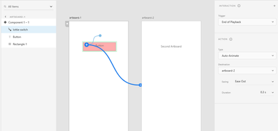

1. You take this empty lottie file, and put it somwehere in the click/tap state of your button.
2. While on the prototype tab, add an "End of Playback" trigger on the lottie-switch, and point it to the artboard you want to go to after the tap animation is done. (lottie already has a time trigger with a 0s delay set to lottie playback, you should leave that one there) It should look like this:
If you're having trouble, here's this quick sample I made so you can see how it's set up.
Essentially what happens is that when you tap and go to that click state, the lottie file becomes active. This lottie file has a 0s timeline, and a 0s time trigger to play, so it plays instantly, and the End of Playback trigger activates instantly as well to transition to the next artboard. Why don't we just have time triggers for component states? Beats me 🙂
