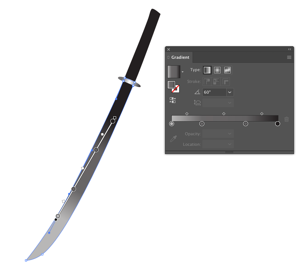

Did you move the gradient around inside the shape? Can you show the complete object with visible gradient annotator in Illustrator?
Explorer ,
Feb 20, 2020 Feb 20, 2020
Hello Monika,
yes, I did. I will attach the screenshot. Thank you!
I'm not sure if Xd supports moving around a gradient like you can do in Illustrator.
So can you try if it's possible to achieve the sane with just using the gradient panel, the rotate angle and the gradient stops?

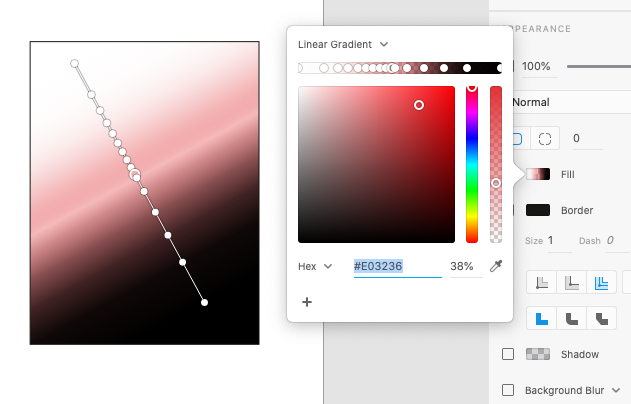

Adobe XD accepts various kinds of gradients from Illustrator very well, both as pasted and imported graphic, with multiple colors, shifts in balance, and even opacity levels. So it must be something with the overall construction of that particular shape, causing XD to mis-interprete the Fill.

Your problem is not the same, because importing or pasting elements with linear or radial gradients into XD work fine !! So there must be something strange with your sample...
When copying/pasting doesn't seem to work, then check this setting in the Preferences (it's in Dutch, but I hope tou can find and verify it). It defines what is brought over by the clipboard:
