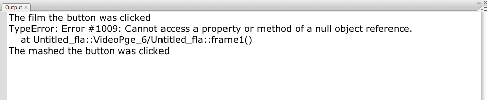

I'm having a similar problem. I have in my project four flv video inside of a movieclip. I have a custom play/pause buttons for each of the four vids (well one generic playBtn & pauseBtn, instance names different for each vid on the generic play/pause buttons) The actionscript I have to play/pause video is this:
          fishyPauseBtn.addEventListener(MouseEvent.CLICK, pauseHandler);
          fishyPlayBtn.addEventListener(MouseEvent.CLICK, playHandler);
          function pauseHandler(e:MouseEvent):void{
          fishyVid.pause();
          function playHandler(e:MouseEvent):void{
          fishyVid.play();
This works fine & it stops & plays the video when there are pressed. But when I use the same script on other video it doesn't work I get this:
function pauseHandler(e:MouseEvent):void{  when I double click on the code error in the compiler error panel tab this is the line of code thats highlighted
function playHandler(e:MouseEvent):void{  when I double click on the code error in the compiler error panel tab this is the line of code thats highlighted
I then renamed the pauseHandler & playHandler to pauseHanddler_B, playHanddler_B, this stops the above error but it doesn't pause or play another
video, I get this message in the output panel:

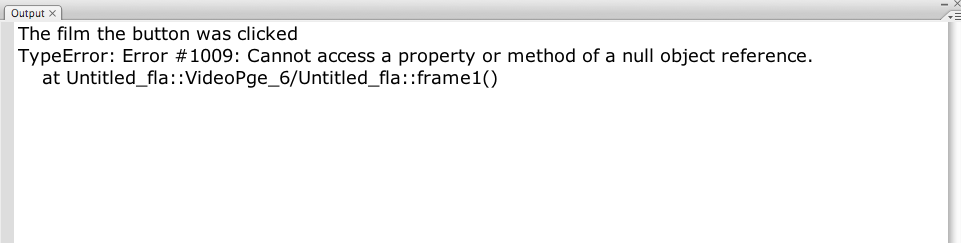

I've tired scripting all the buttons to play & pause the video's in one script like so:
mashedPauseBtn.addEventListener(MouseEvent.CLICK, playHandler)
mashedPlayBtn.addEventListener(MouseEvent.CLICK, playHandler)
fishyVid.pause();
mashVid.pause();
fishyVid.play();
mashVid.play();
But yet again I get this message in the output panel:
