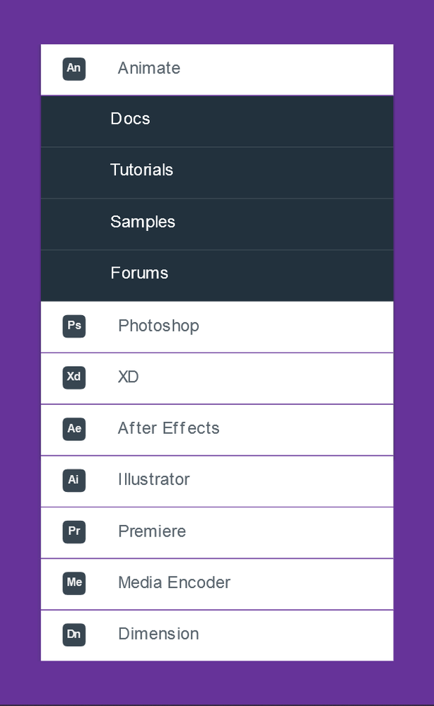

Hi there. Are you taling about a menu type of accordion like jquery or the actual musical instrument?
Explorer ,
Feb 20, 2020 Feb 20, 2020
Oh, not a musical instrument. An acordion navigation piece. I'll attach a sample in a sec..
Feb 23, 2020 Feb 23, 2020
Hi.
First I have to tell that this one was very tricky.
Is say this because I wanna an approach that favors timeline usage to help beginners to get started.
This means that all animations and states have been created in the IDE using frames and tweens. And, of course, there is a bit of JavaScript, but way less than a regular dynamic menu like this would require. The secret keys here are smart structuring and assets preparation rather than crazy and complex code.
Also, this approach has the advantage of allowing the developer/designer to come up with any super fancy transitions or effects because in the end everything is just a simple timeline animation. Another advantage is that the menu is modular. This means you can use as many instances as you want in any place because all the code is inside of the symbol. Generally is not a good idea to spread nested code all over the FLA, but if you know what you're doing than things are going to be OK.
The disadvantages are that you cannot add or remove items without some crazy hack, you always have to contract the menu before opening it again, and only one item can be opened at a time.
I just make a notice that in this example the data is being fed dynamically because I didn't wanna to go over editing 40 symbols. But one can easily edit all the data just by duplicating symbols.
Preview:
Live:
http://bit.ly/2v156ps

FLA / source / files:
https://github.com/joao-cesar/adobe/tree/master/animate%20cc/html5_canvas/timeline_based_accordion_m...
