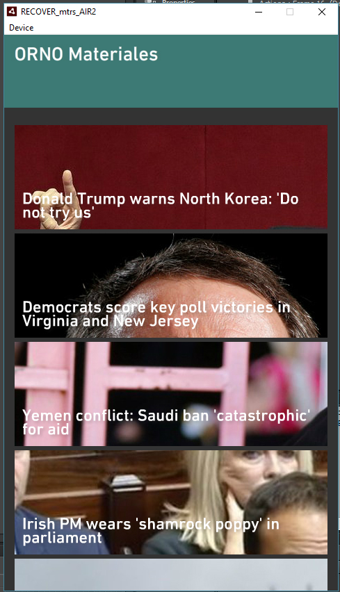

Ok I finally could download it and open it. I do get that kind of behavior your project shows but what I need is a little bit different. I'll attach an image to show.
Maybe this image clarifies what I'm trying to do. What I need is for the images to scale proportionally so the width matches the designated area for the feed item which is 450 px wide by 150 px tall. I don't think they're scaling at all right now. Then position themselves centered inside that rectangle that encloses them. The image will show cropped of course, that's fine, pictures here make up just for a fancy background for the feed. I don't expect my feeds to show much people in those pics since this will be a engineering materials news feed reader.
Nov 08, 2017 Nov 08, 2017
if you do that, your image will either 1) sometimes exceed the height of your library ItemRenderer or 2) not be the correct aspect ratio
Explorer ,
I'm expecting for it to exceed the height of lItemRenderer. That's why I
have a mask over it to crop it. As I said earlier, I pretend the content of
the photo is not too important at this stage. It'll work as a background
for the feed button an nothing more. Maybe I can use the picture cropped
into an square in the detail of the feed.
What do you think?
