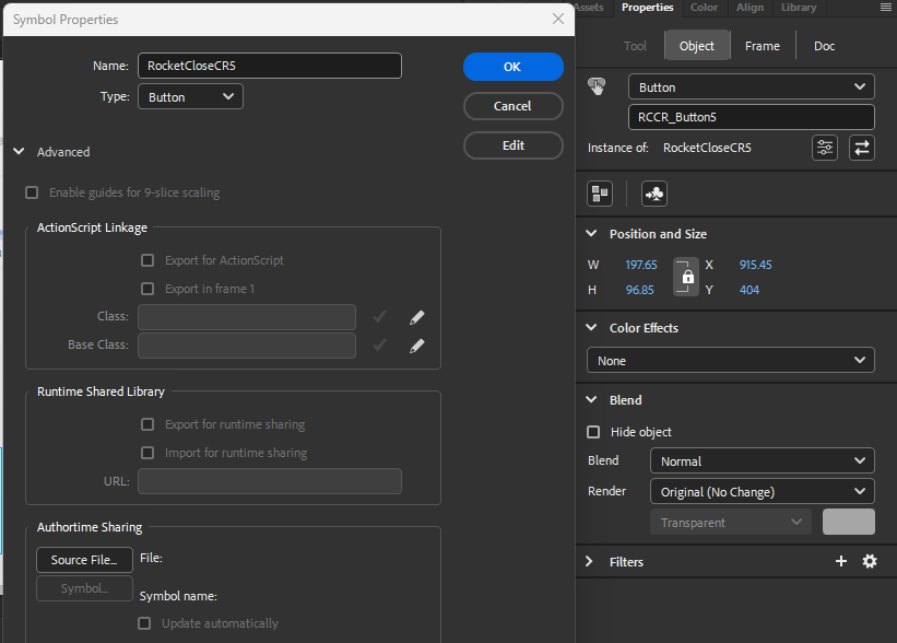

re-enter their instance names in the properties panel
Community Beginner ,
Apr 20, 2025 Apr 20, 2025
Do they have to be anything specific? The instance name is different than the object name.
the instance name needs to match the name used in code.  the best way to ensure that is to copy from the code and then paste into the instance name field.  make sure there are no spaces copy/pasted.
I changed the names to match, and then re- did the code. Im afraid that didnt seem to work either.

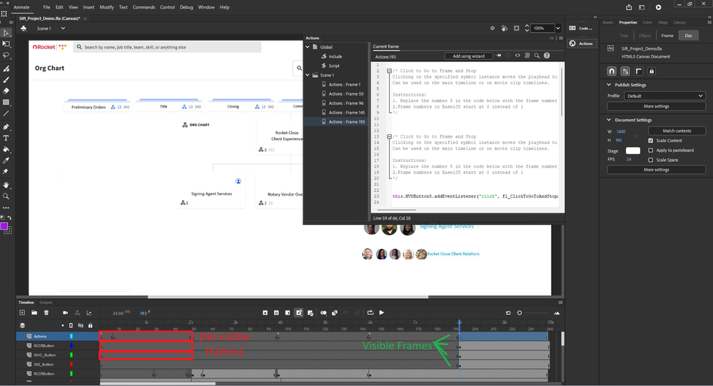

Hi.
Are the buttons and code in the main timeline?
Please let us know.
JC
Apr 21, 2025 Apr 21, 2025
I am new, so my Timeline is not super clean im afraid. Which may be my issue. Here is a picture of my timeline. The hilighted button is the one im trying to use, the actions are on frame 193.

and the button code is on frame 193, correct?
Thanks.
Which frame is the code for adding event listeners to the buttons is located in?
Frame 193 is the frame that both this slide starts on, and the slide for the code actions for the buttons
Thanks.
Try moving the code that adds the listeners to the first frame instead.

ie, you can't reference an object in a frame when the object hasn't been created on stage.
