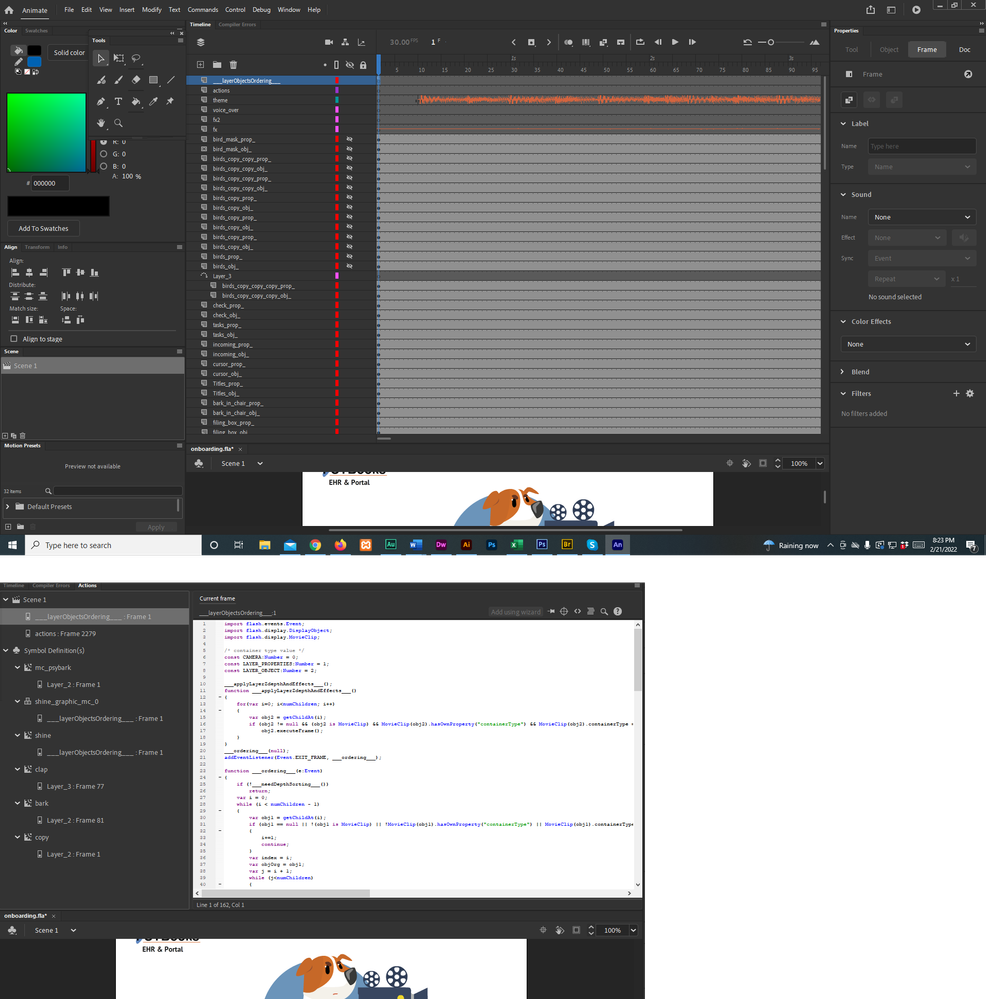

Animate created a script of the folders I had and also created duplicates layers - _obj and _prop
I've never had this happen before and don't know how to fix it. I had my layers all neatly organized in folders. Been working on this project for a couple of weeks with no issues. Suddenly tonight, it took OUT my folders and instead, added a new layer at the top called __layerObjectOrdering - that has a script in the first frame.
Additionally, most of the layers I had were duplicated - one called "name_prop_ " followed by its mate, "name_obj_"
I get compile errors now and although it DOES still play, there are a few errors here and there that weren't there before. Inconsistent stuff. Here's a screenshot of what my layers panel looks like now (top) - the bottom screenshot is the beginning of the script that's been placed in the first frame of the program-generated __layerObjectOrdering layer:

Symbol 'shine', Layer '___layerObjectsOrdering___', Frame 1, Line 6, Column 7 1151: A conflict exists with definition CAMERA in namespace internal.
Symbol 'shine', Layer '___layerObjectsOrdering___', Frame 1, Line 7, Column 7 1151: A conflict exists with definition LAYER_PROPERTIES in namespace internal.
Symbol 'shine', Layer '___layerObjectsOrdering___', Frame 1, Line 8, Column 7 1151: A conflict exists with definition LAYER_OBJECT in namespace internal.
Symbol 'shine', Layer '___layerObjectsOrdering___', Frame 1, Line 11, Column 10 1021: Duplicate function definition.
Symbol 'shine', Layer '___layerObjectsOrdering___', Frame 1, Line 20, Column 10 1021: Duplicate function definition.
C:\Program Files\Adobe\Adobe Animate 2021\Common\Configuration\Camera\Flash\privatePkg\___LayerProp___.as, Line 1, Column 1 5000: The class 'privatePkg.___LayerProp___' must subclass 'flash.display.MovieClip' since it is linked to a library symbol of that type.

    I believe this to be a crack in the shell and a little peek into the so called "Advanced Layers" internals - the unfortunate implementation which has made Animate slow, unreliable and very unpleasant to use.
    The tearing of the hidden wrapping exposes the doubling of everything and should explain the awful performance issues, plaguing the program since v.18-19.
    To avoid this from happening again, my suggestion is to always turn Advanced Layers OFF and use SMR instead of Layer Parenting or any of the other new features.

    Advanced layers are turned OFF via the Modify > Document... menu.
    You can make this default.
    By turning them off, you will lose Layer Parenting, Camera and filters for Graphic Symbols - all new features relying on this double wrapping.
    Incremental saves are done by using File > Save As... a few times a day and adding a suffix to your file name, such as _01, _02 and so on.
    You also must maintain at least two external backup copies of all your work to prevent data loss (nightly backups).
    One of these must be on a device that is not connected to anything apart from during data transfer (air gap).
    How to rescue your current FLA in the absence of a backup?
    Save a copy of this file under a new name.
    Slowly investigate the content of duplicated layers, layer by layer, symbol by symbol, and remove half of them. Rename the rest.
    Save frequently as you go and test.
    It will be a process of examination and elimination until you manage to recover everything that is salvageable.
