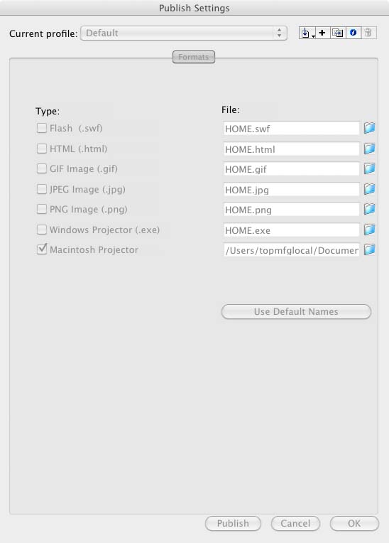

Make sure you have changed your Publish Settings to AS3.
Explorer ,
Apr 26, 2011 Apr 26, 2011
Thank youNed. I thought I had but when I go to confirm I suddenly don't have that option any more. never seen this. Hmmm.cap.jpg
LEGEND ,
You'll find it in the Flash section of the Publish Settings, though I don't see any tabs for accessing the different sections in the image you provided.
Explorer ,
Yeah I know. That's what I find weird. I've never "not" seen the Flash tab.
Explorer ,
Duh. Never mind. I didn't have swf selected as an output option. The tab is there now.
