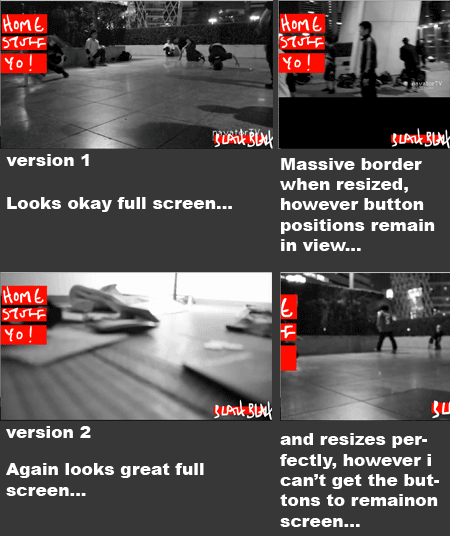

New Here ,
May 09, 2011 May 09, 2011
@AttaBoy2 - Thank you so much for sharing that example, i have finally been able to create a page with a liquid video background that does not show a border depending on the aspect ratio of the browser.
I am still new to actionscript though, i am having trouble understanding how to adjust the code to allow me to include navigation buttons that will not resize and maintain constant positions around the browser window  (like a footer situated at the bottom right or navigation on the left side of the screen)
I have included an example of what the screens look like when resized if that helps, please ignore the silly titles i gave the buttons, it's just placeholder content while i struggle to get the background video to work.
Here is the code for the first version, i've tried to include parts of it into the code you wrote but with no joy, again i am fairly new to actionscript so it's no surprise really, if you can offer any help or point me in the right direction with any tutorials that apply i would be very grateful
// ***Stage aligned top left Stage.align = "TL"; // *** Stop the stage from scaling with the browser window. Stage.scaleMode = "noScale"; stop (); var videoAspectRatio = videoBKG._width/videoBKG._height; // initiate postitions and scaling values for objects videoBKG._width = Stage.width; videoBKG._height = Stage.width/videoAspectRatio; navigation.align = "L"; footer._x = Stage.width - footer._width; footer._y = Stage.height - footer._height; // end initial position setting //create a listner that checks to see if the browser window is resized sizeListener = new Object(); sizeListener.onResize = function() {      // change movieclip properties when the window is resized.           videoBKG._width = Stage.width;      videoBKG._height = Stage.width/videoAspectRatio;      navigation.align = "L";      footer._x = Stage.width - footer._width;      footer._y = Stage.height - footer._height; }; Stage.addListener(sizeListener);
Thanks for your time.
