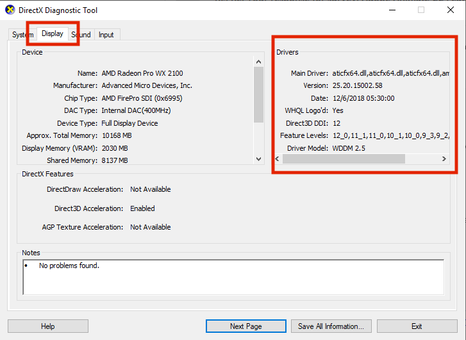

For Fluid Brush tool, the following hardware specs are required to work best.
Windows : DirectX 12 compliant GPU (with feature level 12_0 support)
Windows->Run->"dxdiag" to check the directx specs.
Please share your Directx specifications with us. Also, try to set "Stabilizer" value in Fluid Brush properties to '0' and share a screen recording of the brush drawing. We will look into the issue of yours. Thanks!

I may not be the original poster but I am running into the same issue. My graphics driver features level 12_0, and I did set the stabilizer to 0. This delay does not exist in other software (Photoshop and Clip Studio Paint)
