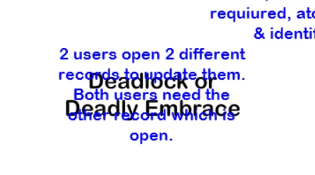

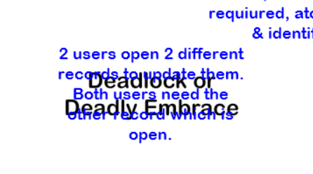

This shows the object being matched:

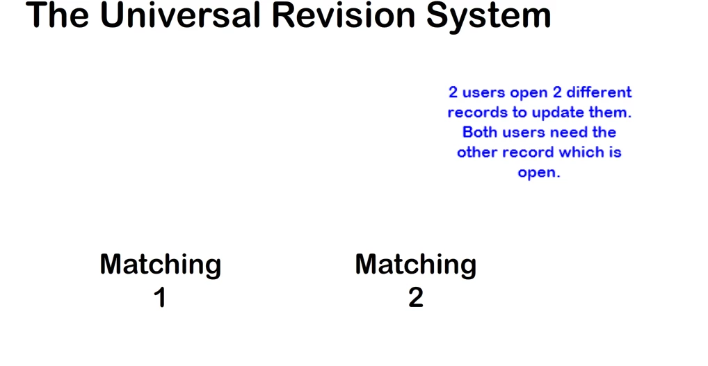

This shows the object staying on the main menu:

    Are you sure you shouldn't be using target instead of currentTarget? I'm no AS3 expert, but that event.currentTarget.parent.addChild(event.currentTarget); line may be ripping the drags out of their container, which would explain why they're not going away.
    I've made a quick fix.
    When the frame loads, all of the objects are made visible and when the back button is pressed I've made them invisible.
    Perfecto!
