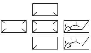

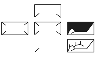

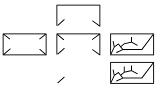

Hi Preran, I've discovered that shapes don't have to be particularly complex to create (even inconsistent) conversion issues. I understand this has been a longstanding issue, but converting lines to fills is a very useful tool for our company, and can only be achieved through a laborious process of double clicking on a fill shape to select it's surrounding lines and converting to fills, then doing the same for the next shape area within the larger combined shape which is required to be converted. Even this can not work and individual lines need to be selected and converted or altered completely before continuing the process throughout the full images shapes.
I have an example flash file that shows how inconsistent this tool can be.
1. Original shapes in line form
2. Lines converted to fills
The process can be undone and tried again, giving a different result:
3. Lines converted to fills (note the shape on the right)
The shape on the right has only one line missing as opposed to the whole section being incorrectly filled.
You can undo and convert lines to fill again to get the result found in 2, alternating between the two results.
