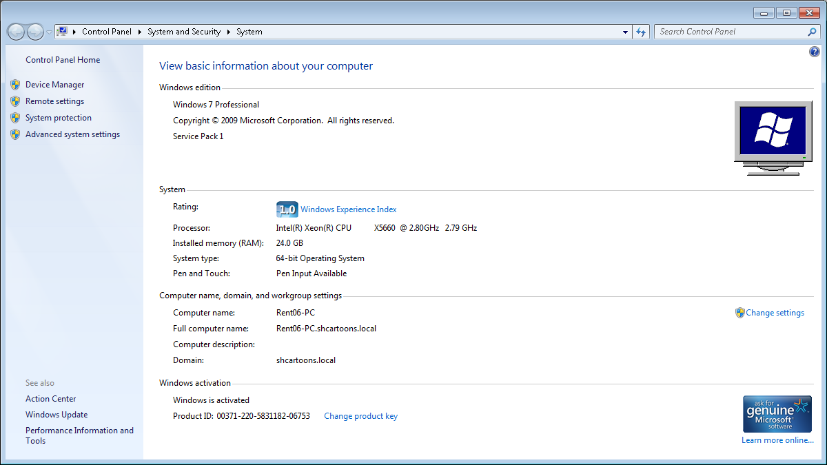

Here is the specs of one of the systems rendering out Flash: win 7, XEON, 12 core with 28GB...
We should be flying thru these FLAs.
M
