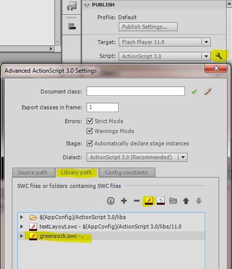

Thanks for the reply, i've just tested the project and it looks very promising. However when i use the same code in my own project i get these errors:
Definition com.greensock.TweenLite could not be found.
Definition com.greensock.easing:Linear could not be found.
and so on...
How do i make flash able to find these definitions?
LEGEND ,
Dec 19, 2013 Dec 19, 2013
Go in your ActionScript 3.0 Settings (the wrench icon next to the drop-down) in your project and include the greensock.swc I included in the project (it's a file), or download the latest and include that. They also offer the normal package non-SWC version if you download it. My SWC is probably a bit old, from 08-2013. It was new enough to demo this basic stuff though.
New Here ,
Thank you it all works now! Clever little plugin that is. Thanks for taking the time to help me
