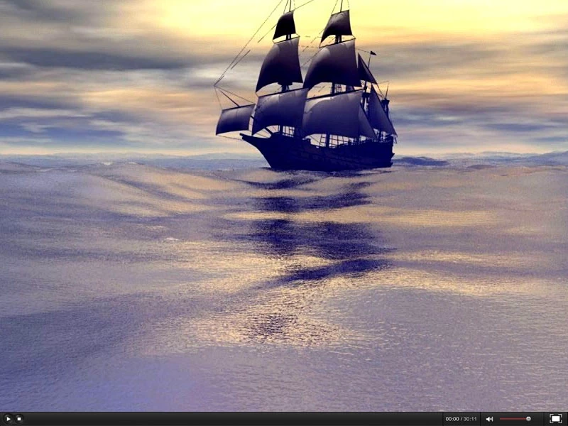

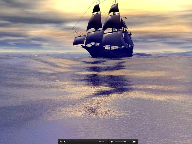

my player 4:3
above script is like below
but i want like this
How to change or build my script?
