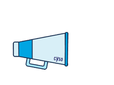

I'm having a problem where, when I parent my layers, my child symbols move in a completely wrong direction. I want the whole speaker and the words to move as one unit while the words slide out.
This is my first frame:
And this is my last (the words slide out from behind the speaker):
I have the words set to Tween < Ease In-Out Quart. When I don't parent the layers, the words slide out along their angle just fine. But, when I parent the layers, this is what one of the tweened slides look like:
I have no idea why it does that but the words are no where near the speaker. This is what the words look like without parenting:
 I'm trying to have both the speaker and words move in tandem without interrupting the movement of the words sliding out.

They're not nested though, i see 4 layers. Nesting means taking those 4 symbols and put them inside a newly created symbol.

I realized I forgot to set parenting in the first keyframe and only had it set to the last keyframe. But, even then the words are nowhere near. I haven't changed the last keyframe with the final position
Nov 16, 2021 Nov 16, 2021
Try this, take the text layers and nest them in a symbol by selecting them, right-click and choosing 'Convert Layers to Symbol' from the contextual menu.
Once done parent that to the speaker.
You could also just nest everything including the speaker and it'll work just as well.

They're already set as symbols 😞
