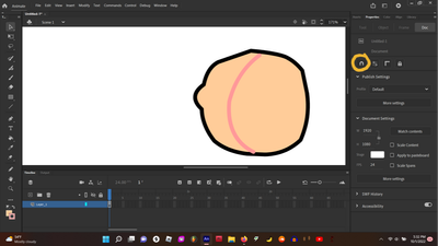

So I'm trying to make a shape with the line tools, so I go to shade my drawing.
but I can't fill it in because my different color line is not snapping to the black lines.
how do I fix this?
here are my line tool settings.

Click the magnet button to enable snapping, it's currently off per your screenshot.
Try to overshoot the color line, you can delete it later. The bucket tool also has a fill gaps function, it's in the properties panel under the tool tab when you have the bucket tool selected.

If you right click, you should be able to access the snapping settings.
Community Beginner ,
Oct 01, 2022 Oct 01, 2022
Try right click and open the Snapping settings. "Snap to objects" should fix it.

it still didnt work 😞
