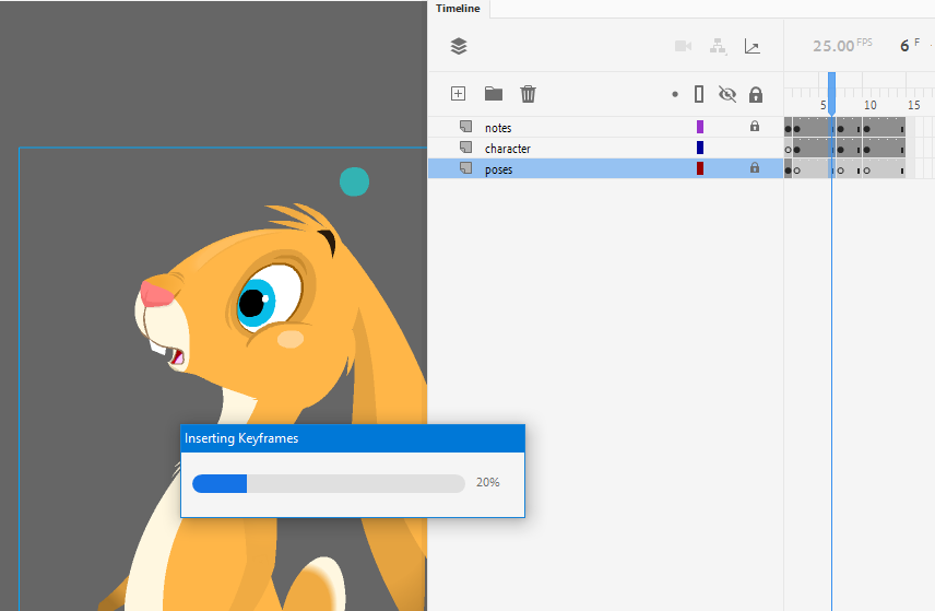

In a project that uses a lot of layers
Loading occurred when inserting a frame.
Even simply inserting blank keyframes from another layer causes long loading.
This is a phenomenon that did not exist in the previous version.
It seems to be an optimization problem.
It seems to be a problem after this update (2021.12.15), is there anyone experiencing the same problem as me?
Attach videos and files.

Hello, I created a new project and tested it, all the project files have that problem.
The same happens whether the project file size is large or small.
Loading does not occur when inserting or deleting 'frames'.
This only happens when performing commands related to inserting 'keyframes'.
And if there are multiple parents on different layers
Loading felt a bit longer.
It's like every time a keyframe is inserted, it recalculates the parent of every layer.
Attach the video.

I can also observe the behaviour and it is only happening in AA 22.0.2 (tested on Windows 10) with even the simplest of files with no layer parenting or Advanced Layers on.
