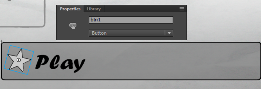

My button is located inside of a bar that bounces onto the screen, the bar's instance name is nav and the button's name is btn1. I'm fairly new to learning how to code these kinds of things and wondering if someone could figure out my problem.

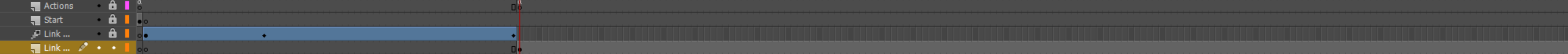

In my animation I have a linkbar layer where I put my nav bar, it comes in bouncing using a motion tween, but my animation is longer than the motion tween and I could not figure out how to keep the motion tween on just those frames instead of extending it so I copied the nav bar and put it on another layer, I was wondering if the double nav bar was messing up the coding? The first nav bar goes off the timeline on frame 61 and then the next frame the new nav bar with the same instance names comes in on frame 62 along with the script

In my animation I have a layer named linkbar where I store my navigation bar, I had to create two link bar layers both with the same instance name of nav aswell as the buttons having the two smae instance names, I couldn't figure out how to keep the motion tween on the nav bar while extending the frames to go past it, that's why I created two nav bars. The first nav bar dissapears on frame 61 and then the second one comes in on frame 62 along with the script

I was wondering if maybe that is what is interfering with the code?

Sometimes we create buttons from existing buttons - check it (or prepare a new one with valid instance name) - maybe it helps?
