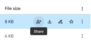

Oct 24, 2023 Oct 24, 2023
In Google Drive, click on the sharing icon:
Then choose "Anyone with the link"
Test the link in an 'incognito' window. Then you will know if you can see the file when you're not logged in as yourself.
You may need to post the link again here.
