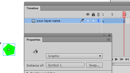

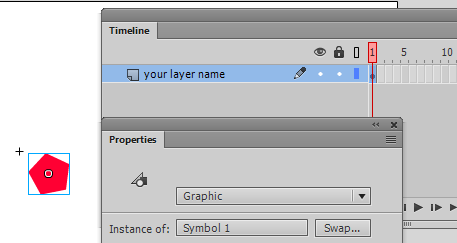

if your paw uses 10 frames to display its animation (on the paw) timeline and you put your paw on the last frame of the main timeline, you won't see the paw animation.  there needs to be 9 (non key) frames after the main timeline key-frame where your paw was added in order to see the full 10 frame graphic when viewing the main timeline.
(the ss below are of the main timeline.)
ie, this won't display any graphic animation because there are not enough frames on the main timeline:
this will display the graphic animation when scrolling/playing the main timeline:
ie, notice there are no keyframes on the layer that contains the graphic instance and that pentagon has changed from red to green displaying the animation that's on the graphic's timeline while on the main timeline.
