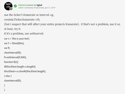

use the ticker's framerate or interval. eg,
createjs.Ticker.framerate=10;
(but i suspect that will affect your entire projects framerate).  if that's not a problem, use it or, at least, try it.
if it's a problem, use setItnerval:
var s = 'this is your text';
var F = f.bind(this);
var fI;
clearInterval(fI);
fI=setInterval(F,400);
function f(e){
if(this.tf.text.length<s.length){
this.tf.text+=s.charAt(this.tf.text.length);
} else {
clearInterval(fI);

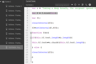

Hello! I have encountered an error in the codes you inputed.
The error indicates that this var F = f.bind(this); was the issue.
I'm using ActionScript 3.0
Looking forward to your response
Thank you!
Community Beginner ,
Aug 18, 2023 Aug 18, 2023
cont.
This is the error message
Scene 1, Layer 'TEXTBOX', Frame 1, Line 3, Column 11 1061: Call to a possibly undefined method bind through a reference with static type Function.

Aug 19, 2023 Aug 19, 2023
I copy-pasted your codes and this error appeared when I previewed it, as I mentioned previously. And when I right clicked on the said error, below is the highlighted source of problem.
This is what it looked like with your codes.
