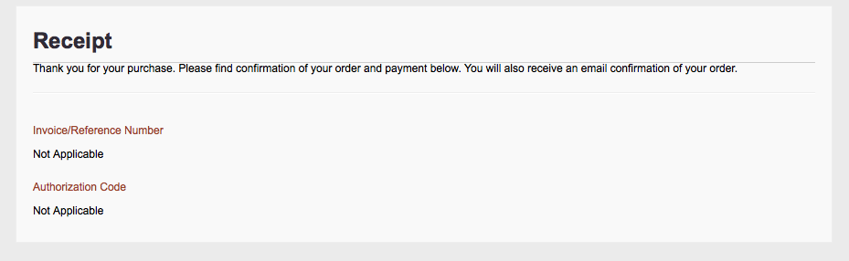

Hey Liam,
I've tried what you suggested and have some interesting results.
The one thing i wasn't so sure about was this part.
...instead of specifying the order retrieve page (which has paramaters in the url) to be the return you can have -1.
Here's the new problem:
When I submit the form from the shopping cart, it creates an order and sends me to the order receipt page
The order does not show up on the dashboard. however, it shows up under orders and it propperly ticks the wholssaleer box and submits the custom crm entry.
Since it is placing an "order" it clears the shopping cart which is worse than it not showing the correct price.
Any ideas?
