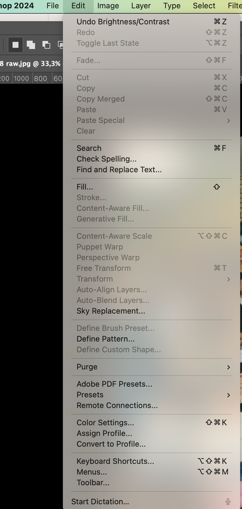

But I have no "Edit>Preferences>File Handling" in my Photoshop 2024?
Do you have anohter Photoshop than I have?
Please see my option in "Edit":
Advisor ,
Oct 03, 2023 Oct 03, 2023
Looks like you are using a MAC.  I'm afraid I have no experience and can't help you there. My PC version shown a completely different menu under Edit.

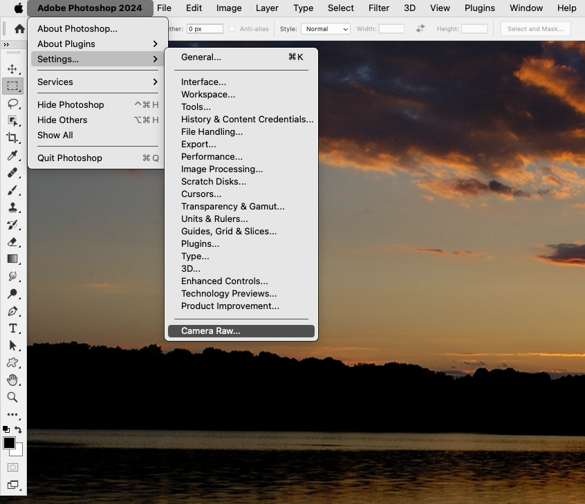

I may have found it for you.
Apparently it's under Photoshop>Preferences on MAC and Edit>Preferences on PC!
Oct 04, 2023 Oct 04, 2023
Yes look under Adobe Photoshop 2024>Settings or Preferences
