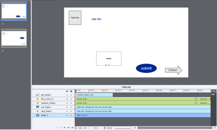

I have a colleague who is trying to add a .gif to several slides in a Captivate project. The idea is that when someone clicks a button a little .gif showing confetti plays. The advanced action she is using is very simple: on success of the button click, a shape disappears, a bit of text disappears and the confetti .gif plays. It works beautifully on the first slide, but then the .gif won't play on success of the button click on the second slide. We've tried everything we can think of (and were able to get it to work in a different program) so we're wondering if this is a glitch or if there is some reason Captivate won't let this happen or, of course, if we're missing something.
Here are some shots of a very small test I've done, recreating her issue, to try very simply to get the .gif to play on the second instance, but to no avail. and attached is a small clip of what happens on the first and second slides (the .gif should appear on the second slide too).
Any ideas?

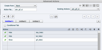

Entdecker ,
Aug 23, 2023 Aug 23, 2023
First of all, thanks once again @Lilybiri - I seriously don't know what the Captivate forum would do without you. You're always first in the pool with your support 🤩.
What you're saying makes complete sense, but I tried to follow your lead here but I still can't get it to work. It still works fine on the first slide (and you're right, a second click on the same button produces nothing) but still no luck on the second. The video I included in my first post is still what happens. Here are the updates I made to the advanced actions...is there something I missed? Did you try it with two slides?

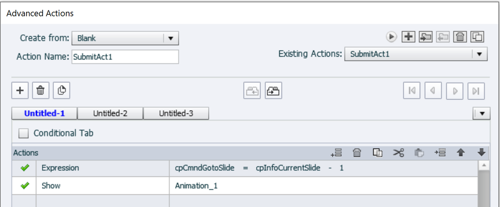

LEGENDE ,
Yes, I tried with two slides although I was sure it worked. The expression command is meant to Replay the slide, so that the playhead gets back to the first frame of the slide, where the animation timeline starts. Proof to you: my second submit action:
Is the Timeline of the second slide identical to the first one?.

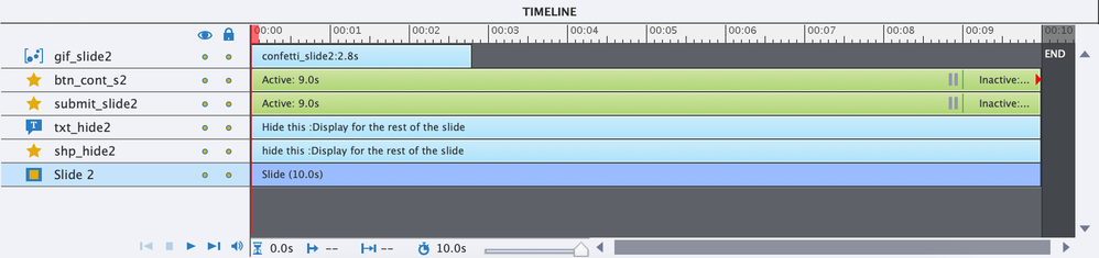

Entdecker ,
I can't imagine anyone hating you - honestly, I don't know how I would have been able to learn so much without your support. Even when I work on other projects I remember things I learned from you in this forum and am able to go forward on my own and learn more. That is beyond invaluable; anyone who doesn't appreciate your efforts doesn't deserve them (and is too ignorant to know the value neither of you are offering nor the time you invest in our community support) 🤷🏻.
So yes, my timelines for both slides are identical:
Screen Shot 2023-08-23 at 1.13.38 PM.pngScreen Shot 2023-08-23 at 1.13.31 PM.png
The only two things I haven't mentioned are that the .gif has been modified in Photoshop to play only once, not loop. I tried to use one that loops eternal when this first didn't work, and Captivate wouldn't even play that. And each slide has its own file so I don't know if that would even be an issue (especially with the Expression added)...?
The second thing is that the animation is set to not visible in output (which I'm sure you guessed given the Show command we are using).
I just tried it again, with two new slides in a new project and it still doesn't work for me. I'm not sure what I am missing 😟.
