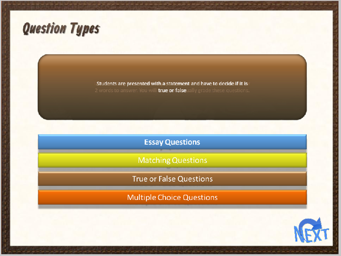

OK, I have a relatively easy question for you guys. I have a slide with four persistent buttons on it and I want a link to the next slide to appear after the four buttons have been clicked. What confuses me, however, is that I'm not sure where to put the "Advance to Next Slide" button on the timeline.
I'm assuing that the problem is that I have all the buttons set to pause at the same time, but I'm not sure what the alternative would be.
I've attached pictures of my slide and timeline below. Any feedback you could give me would be much appreciated. Thanks.

Is there a sequence imposed for clicking the buttons? And what do you want those buttons to do? Can the user click multiple times on each button?
In your present situation, clicking one button will release the playhead and it will continue till the end of the slide.
If the sequence is imposed, you could stagger the button timelines, so that the pausing point (between active and inactive part) is earlier for the first button, bit later for the second etc. In that case you can use the present setup for the button: make it appear just after the pausing point of the last button to be clicked.
If the sequence is not imposed you'll have to use advanced actions? I'll explain when you have answered my questions.

Thank you for responding to my question so promptly. The idea is that users can click the buttons in any order and as many times as they like. Whenever a button is clicked, information is displayed in the box above the button.
My preference would be not to impose a sequence and use an advanced interaction. I'm just a little unclear about how I would do that.

OK Walter, then you really need advanced actions for the buttons. Noellet gave some ideas but it will not work if the user can click multiple times on each button, sorry Noellet. I will try to explain why: in your scenario the Next button will also appear if the user clicked four times on the same button
Walter, you need to create one user variable for each button, I will label them v_one, v_two, v_three, v_four.  You do not need to give those variables a start value at all. They will be set to 1, when the corresponding button is clicked the first time. You will need a conditional advanced action for each button, and as Noellet correctly pointed out, the 'Next' button has to be initially invisible.
Each conditional advanced action will have to do several things, showing the text caption and hiding all other text captions, set the value of its variable to 1, check the value of all the user variables and if they are all=1 the next button will be made visible. Easiest way will be to create indeed a counter variable as well v_counter.
Would use 2 decisions: first will be a mimick of a standard action, second will be a really conditional action. For the first button, where the Text Caption is TC1 this will be:
First decision: IF 1 = 1     (will always be true, so THEN actions will always be executed
                    THEN      Show TC1
                                   Hide TC2
                                   Hide TC3
                                   Hide TC4
                                   Assign v_one with 1
                                   Expression v_counter = v_one + v_two
                                   Expression v_counter = v_counter + v_three
                                   Expression v_counter = v_counter + v_four                    need 3 expressions to calculate v_counter
                                   Assign rdcmndGotoFrame with rdinfoCurrentFrame      to rewind the playhead
Second decision  IF v_counter = 4
                         THEN  Show BtNext      shows the Next button
                         ELSE  Continue
Did not try it out, let me know if it works, logic is OK

Yup, it works. I changed it a little bit and instead of using the v_counter, I just made the 2nd decision:
IF
     v_one = 1 AND
     v_two = 1 AND
     v_three = 1 AND
     v_four = 1
THEN
     Show Next Button
I also removed the ELSE statement, as I wasn't sure what it was doing.
