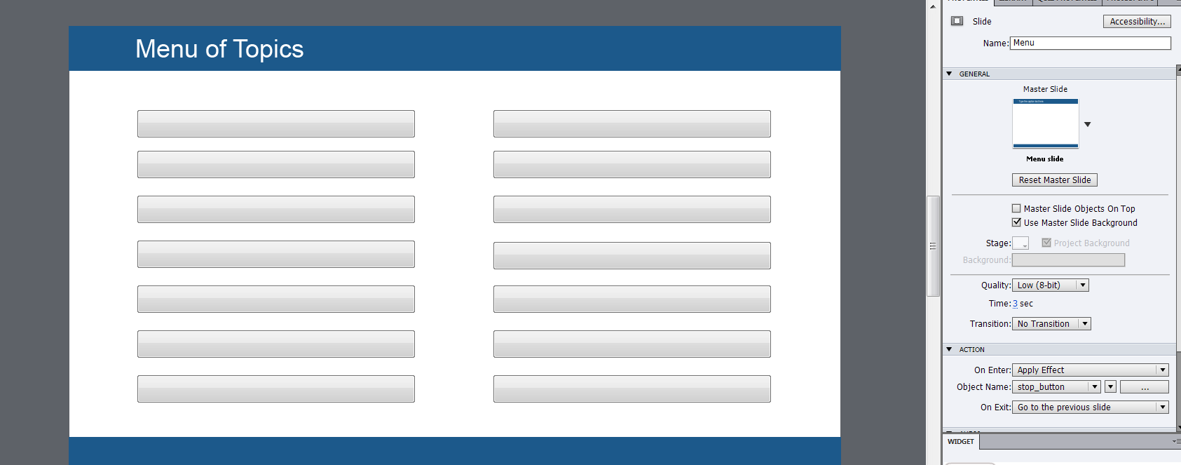

I'm brand new to Captivate and, I must say, I'm underwhelmed. How does one go about simply adding text to a button? When I add a caption, all the existing buttons disappear leaving only one on my menu page (a template from a co-worker) and, the caption (I assumed this would be the Button Text but....no....) doesn't appear.  The action is "Jump to Slide". It's Captivate 6.

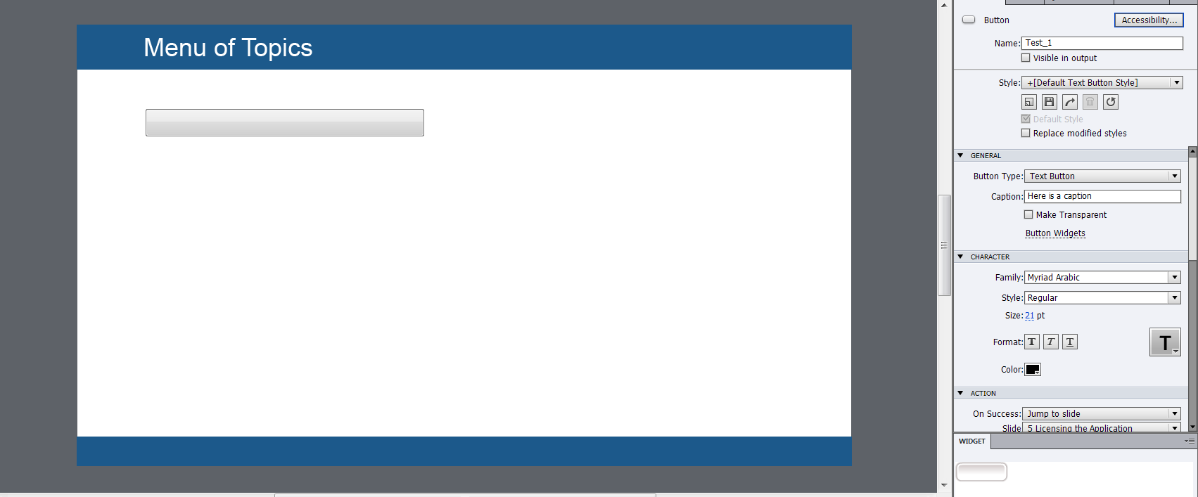

Normal buttons: label on the button has to be changed in the Properties panel, I think it is indicated as 'Caption'. Only for shape buttons it is possible to double-click on the shape and type the text in place. I'm sorry, cannot offer you a screenshot because CP6 is no longer on my system.
As for what happens with buttons disappearing, I have no idea. Maybe you could try to post some screenshots?

Those are Text buttons. The label on the text button has to be put in 'Caption' as I told. But I see that the used character is an Arabic font. Is your system set up to be able to show that type of fonts? I am not sure CP6 already supported not-western fonts. Could you just for a moment try out another font?
I have no idea why the buttons are disappearing. There is an action On Enter for the slide, which Apply Effect to a button. The slide quality is set to Low and there is a dedicated master slide. Do you see all those buttons on the Timeline?

Ah, more font issues. I had to delete all my fonts before this POS would even load. Thanks for your help, I'm sure that's the issue. Time to start looking for a real product that actually works with common fonts and doesn't crash every 10 minutes.

No,  it seems linked with the fonts. In the screenshot you'll see that an Arabic language font was used, not sure that CP6 supported those fonts. Moreover OP was using a template created by someone else, could also be an upgrade issue. Version 5 or 5.5 to 6 could have that type of problems.
