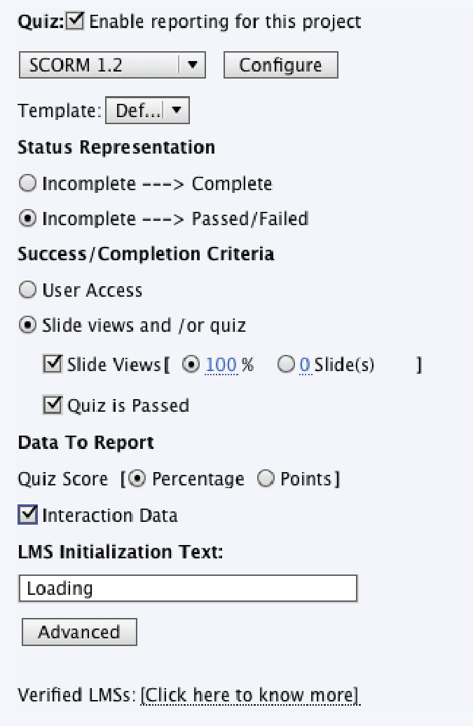

Here is a screenshot of the Quiz Reporting Preferences
Clarification: I'm not trying to publish to an LMS just yet. I currently use SCORM Cloud and am just configuring the project to be SCORM-compliant. However, a blank project, without any quizzing or reporting elements, doesn't publish correctly either. I can't even get the projects to publish to a lone .swf file. I should note that I have published using Captivate 6 successfully before. It stopped working about a week ago. . .
