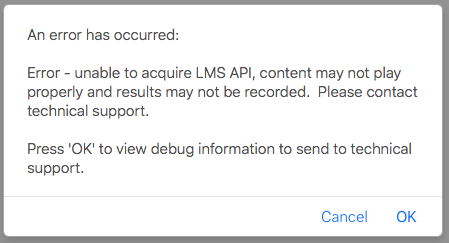

After everything finished uploading, I clicked on the htm file and received this error:
When I hit "OK" a blank screen shows up and nothing happens.  If I try to click the htm again and when the error pops up, click on "cancel...."  Then the tutorial loads and plays in the browser (using Safari).... maybe I should try Chrome...?

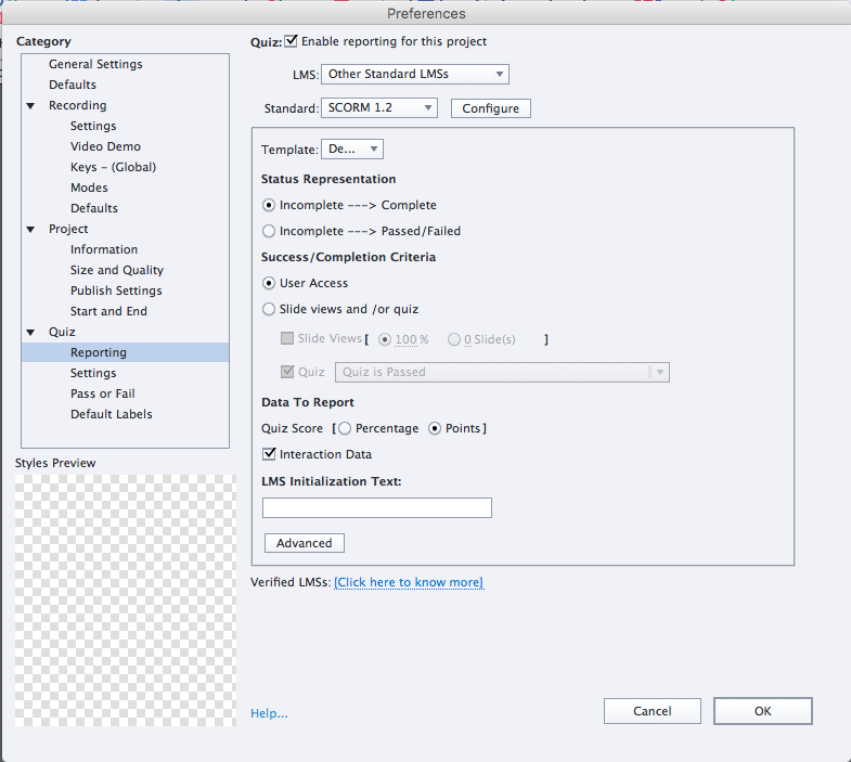

More settings:

Some LMS's allow uploading a 'package', which would have been your zipped published folder without reporting (not a SCO). You would have to indicate to unzip the package and launch the index.html file. It looks like your LMS doesn't have that functionality?
Any LMS will accept a SCO which means you have to turn on reporting (use SCORM1?2), you kan indicate just a % of slides to be viewed as criterium. You get a zipped folder automatically, and uploading should now work easily.

So should I publish as a "reporting SCORM1.2?" or just uncheck the "reporting feature?"  Does that matter?

I have a new question though... no matter what file I try to open... the SWF or HTML.... I get that error code I pasted above: the "unable to acquire LMS API" one... If I hit "OK" nothing happens.  (blank white screen).  If I hit "cancel" the tutorial loads and works perfect... (except for missing videos in the SWF version).... HTML version plays fine.
I would like to get rid of this error code so it doesn't confuse learners if possible.  Any ideas?

I published as SCORM 2004 and uploaded to another LMS Brightspace (working with that LMS on another project I'm designing in CP 9 as well) per these directions:
1148: How to Import a Captivate file
I upload the exact same project that I have been trying all morning to get to work in Canvas.
The uploaded worked as outlined in the link with no problems.
When I clicked on the linked file in the newly created Brightspace module... the error code showed up again:
But just like in Canvas when I clicked "OK."  The tutorial began to load... then it played perfectly... this time INCLUDING the videos!  --and I didn't change anything with the videos in Captivate 9 before publishing for Brightspace.
... what does this mean? ... is it something with Canvas (the other LMS?)  Is there anything I can change to get the videos to show when I put the published tutorials into Canvas?

PS... why do I keep getting this error message (see image above) and how do I get that go go away.  That will confuse my learners.  Thanks!

I also don't know how to get rid of that error code... (the 1st one I posted).  That would be nice to do...(get rid of the error message when the tutorial is clicked/opened).

Error code - You are probably getting the error code because you turned SCORM on when you published the file. Re-publish the file but turn off the "eLearning output" in Captivate. It should read "Disabled" when you go to publish it. Since you probably have it enabled, it is giving you an error message because it is unable to connect to Canvas' SCORM API.

I followed your advice and re-published without enabling the SCORM reporting.  That got rid of the error message I was getting.  Your explanation also makes sense why I was getting that error since Canvas (LMS) isn't set up to work with SCORM at this time.  #notmyfault

Can you help me get the videos working?  ... and be able to open both the htm file and the pdf file from Canvas without having to download?
thanks!
--I published as SWF and PDF only.  Couldn't use HTML5 bc I'm using rollover features.
Thanks!
