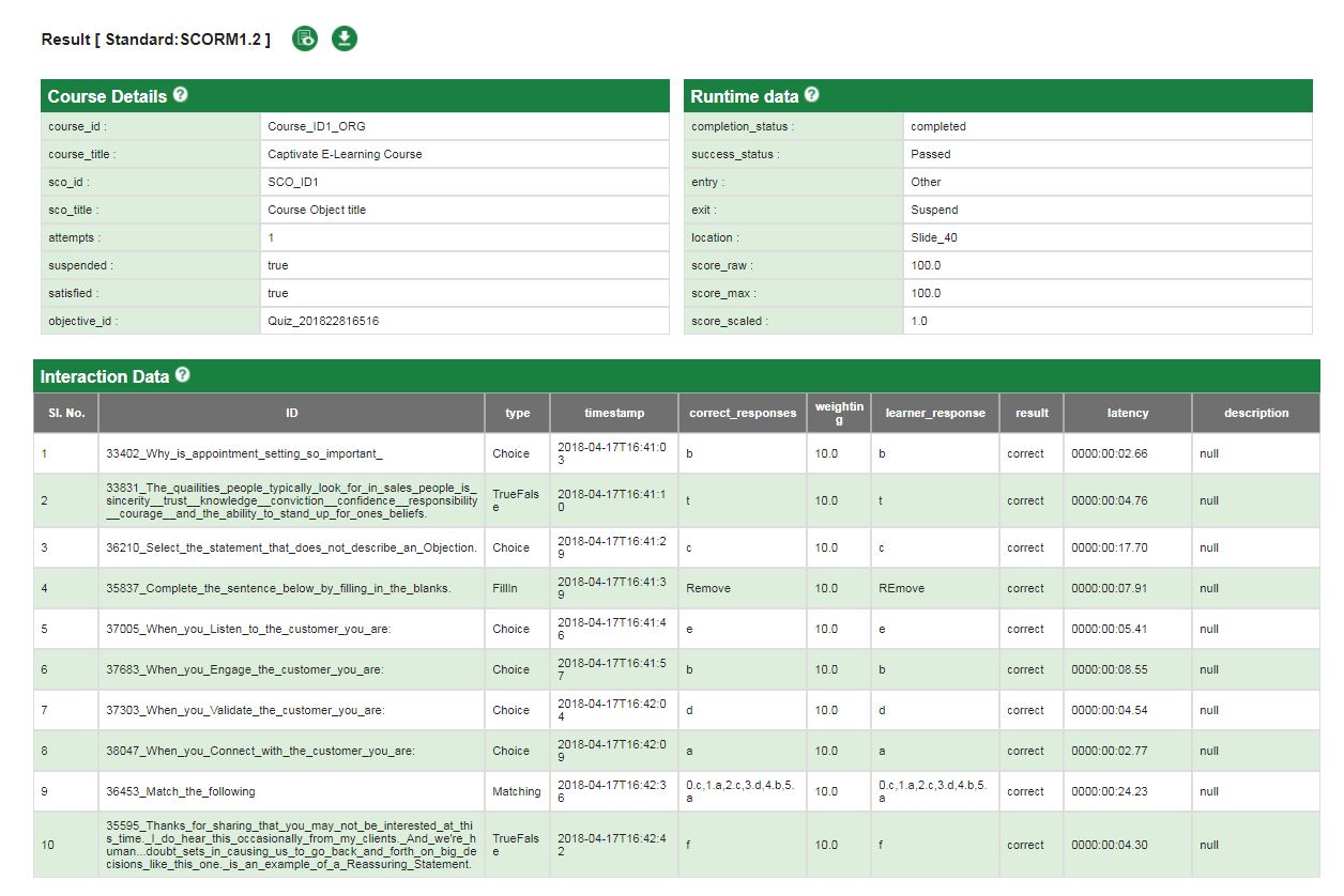

I mean when I use the LMS exit button out side of the module everything registers perfect. Registers complete with Test scores. When I use the standard Quiz continue button set to exit the course isn't registered complete.
This happens with all the modules we uploaded so far created by multiple authors.
I am curios why the external exit button works fine. And why SCORM cloud registers the module complete/passed
Take a look at this screen shot it might shine some light on what I am doing incorrectly.
