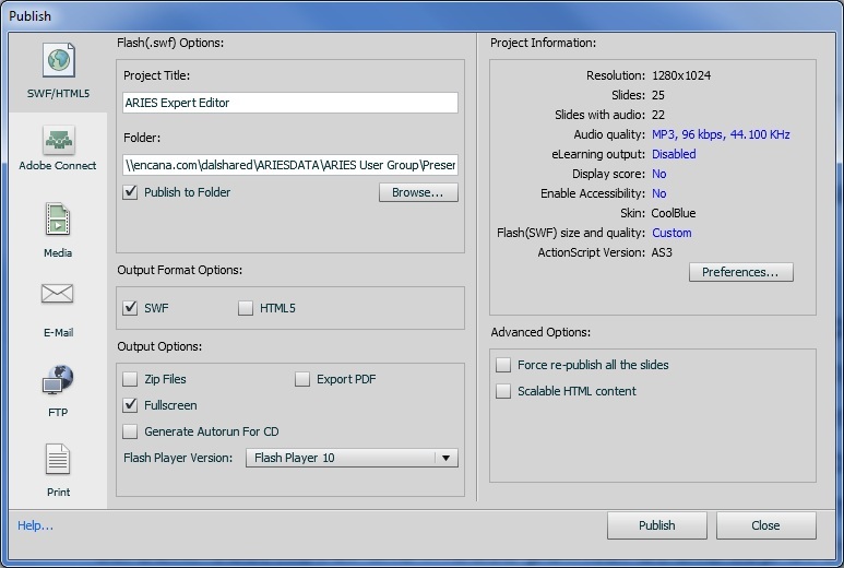

I don't know the answer. I have been publishing as shown below. I have to dbl click the picture to show it, not sure how it is supposed to work but I do publish to SWF, Fullscreen
Settings are 30 FramesPerSec, Include Mouse, Include Audio, Publish Audio as Mono
Custom Settings with no boxes checked and Bmp: High(24bit) and Jpeg: 100% (not compressing anythying)
The .swf file is a bit small but will do. The "_fs.htm" is the one I prefer as it takes up the whole screen and I hide playback and ToC controls using overlay etc. Hover mouse to reveal them.

Ok Rod, I did it. I set the network folder as a trusted location and the results are the same, using links to the folder does not work, even after rebooting the PC, as and extra measure. However that Adobe link you provided was VERY useful. It recommends not using a LAN and warns of using Links. Odd that my addressing those issues and making the published folder a trusted one did not fix though.
Then I copied that same entire folder to my local PC hard drive and it works perfectly. I have not set my local hard drive as a trusted location so it must be by default I suppose, but in any case it works there but not on the network drive. I emailed myself a link to C:\temp, which is where the publish folder was copied and used that to navigate from the email to the copied folder.
Most of the rest of the details can be found in my posts above. IMHO the option to internalize mp4 should have been included in version 6. I think that would resolve this issue. It's a big .swf in the end but much more manageable and easy to work with. Thanks for your time in any case, Rod.
