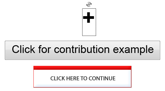

Thanks @rickhumpries86. What I did was I narrowed the problem down to a text animation. I only left 2 elements on the stage:
1) A button
2) A text animation (a plus sign)
In this first picture of the stage, the problem exists. The frame of the + is indicated but is not overlapping the button.
How I corrected it was I had to move the text animation up about 9 times (Ctrl + up arrow) to the position indicated in this next screen shot. Then there was no interference from the + text animation. For the animation I used the Disperse effect. To get the + sign that large, I used Arial size 72 font. So I'm not sure if this is considered a bug, or there is something else that I'm not understanding about the interaction of the text animation and its affect on the stage to other elements.
Feb 11, 2014 Feb 11, 2014
The interference zone might be taking into account the total area covered when the animation 'disperses'.  Try a different text animation option and see if the interference zone changes.
Participant ,
Good idea Rod. I tried 3 different randomly chosen effects and unfortunately the problem remained.
So then I started experimenting with the font size and voila! That was the problem.
Using that large of a font seems to create an invisible boxed frame that interferes with the mouse over of the button. Each time I reduced the font size and re-tested, this slowly added back the proper mouse-over effect of the cursor over the button.
I then deleted the text animation and recreated it from scratch and was able to reproduce the problem again.
Participant ,
Feb 12, 2014 Feb 12, 2014
I was able to work around this bug with the following solution:
Do not use the text animation. Instead, use a text caption and add the effect using the Effects panel. Looks and behaves indentically to the text animation but it doesn't create the invisible interference frame. Works like a charm now!
