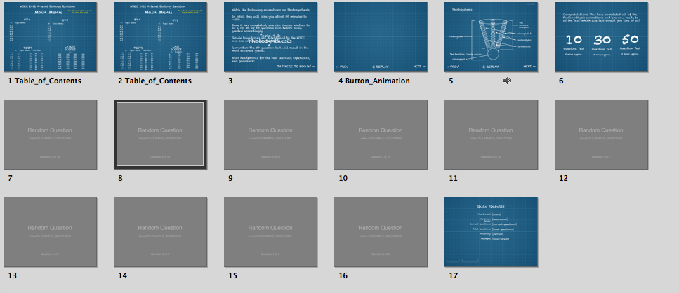

Sadly though, I've come up against a bit of a wall. In my project, I want to have 3 separate quizzes that all use the same question pool; a 10, 30 and 50 question-long quiz. Each one needs to have its own results page.
It's easy enough to see what I mean by looking at the screenshot below:
The idea was to have about 105 slides in total, with slides 10 - 20 being the 10 quiz slide, 21 - 51 being the 30 question quiz and 52 - 102 being the 50 question quiz.
There are three invisible buttons placed over those 10, 30, 50 text boxes. In the picture, the '10 question' button would jump to slide 10, the '30 question' button would jump to slide 21, and the '50 question' button would jump to slide 52, jumping the user to the start of their designated tests.
Though I can create the 10 random question "block" easy enough, when it comes to adding the 30 question "block" it just adds the new random questions to the existing random questions. I want three separate quizzes, each with their own results screens please. (I don't want to daisy-chain to external projects, because the results of each test need to be used within the homepage.)
It just adds them on to the existing block!! Argh!!

As you already did see, Captivate can have only one quiz in a file. The easiest way would be indeed to have 4 files: a main file with the links and 3 quiz files as you described. It is possible to keep the values of the quiz results in a user variable and transfer those values to the main file, using one of Michael Lund's great widgets:
Load and Save Data
It will also be possible in one file, if you are willing to use advanced actions, but should have to try it out with questions from a question pool. You can keep the result of each quiz in a user variable.

I must say I have a little sympathy for the Captivate developers on this occasion.  As you say, they've created an application that does so much, that when you eventually run into a hard boundary of some kind, the effect is somewhat jarring.  However, every application, no matter how good, has limits.  I'm probably one of the worst offenders when it comes to asking the Adobe Captivate Development Team for enhancements (I think I've logged over 70 enhancement requests for Captivate 6 alone).
In your case, you want to have three different quizzes in one project file, each with it's own separate Quiz Results page.  Lilybiri's blog explains how to set up your own faux Quiz Results pages using system variables and custom user variables, but you're going to find this to be quite a lot of trouble.  Even if YOU want to consider these as three separate quizzes, as far as Captivate is concerned they're just one big quiz with 50 questions.  So Captivate will calculate it's internal results based on a 50 question quiz, even if your users select the 10 question version.  So achieving a final Pass/Fail result is going to be problematic at best.
As Lilybiri suggested, your better strategy would be to break this up into separate modules so that you can get your three separate quiz results (all done in standard Captivate) as well as correct results based on the actual number of questions done by the user.
As far as grades A-F is concerned, there's nothing to stop you from using Advanced Actions and User Variables to calculate the user's score as a grade.  You need a user variable that stores the user's grade (e.g. var_Grade). And you need a fairly complex Conditional Advanced Action (e.g. caa_CalculateGrade) with several clauses each of which goes something like:

While Lilybiri and RodWard explained the 'one quiz' limitation, you are not limited to the random questions.
Not sure if I'm understanding your question there but you can create more than one pool of question slides then link each random question slide to a separate pool.
So you'd have a pool for the 10 question quiz, another pool for the 30 questions, another pool for the 50 questions. (Quiz > Question Pool Manager > (click the + to add another pool).  You can then create or drag/drop question slides into the pool using the question pool panel.
On each random question slide you can either specify which pool they'll use when you insert them (Insert > Quextion Slide > Random Question > Linked Question Pool) or In the Quiz Properties Panel for each slide you can select them after being added.
On the last question slide for each 'quiz' you'd have the on success/last attempt action jump over the other quiz slides to some kind of score slide.  Systematically determining if they pass/fail is a little tricky I suppose, as Rod mentioned above.
