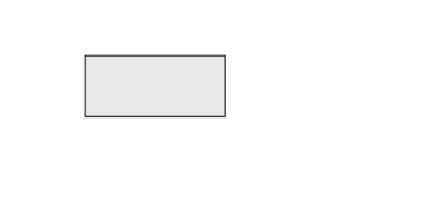

Is this minimalistic example along the lines of what you were thinking?

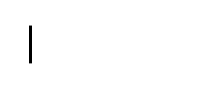

That example is similar to what I would like, but the box is just a narrow vertical bar, the box you've show does the job of hiding the text, in my case the text is visible to the left of the box as it slides in, which is what I am trying to mask out of view.

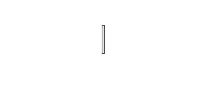

Well, that does complicate things a little further.
What I have done here is to place a white box with no border over the text and shrink the larger box. This serves as the mask but your specific environment may be less suitable for that.

Yes, that's the effect, unfortunately a white cover-up box won't cut it!
My background has an image that is animated in with slide and scale effects, so unless I take a cutting of the exact position of the animated background to use in place of your white cover-up box it won't quite work.

Well - I have something that may possibly work that does not involve any boxes to mask the text.
It would involve adding another HTML5 Animation to your stage, though.
You may already have a similar solution with your own tools but wanted something more Captivate native in order to avoid that which I am not convinced is gonna happen for this scenario.

That looks great, if you could share your solution project, I'd be most greatful.
Hopefully the text is easily adjustable within Captivate itself, but I may be asking too much!
I think your right, it is just another failing of Captivate native!
