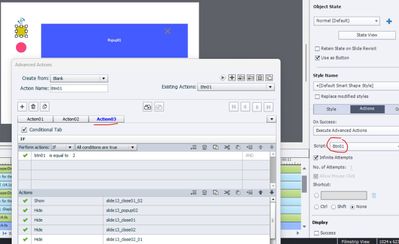

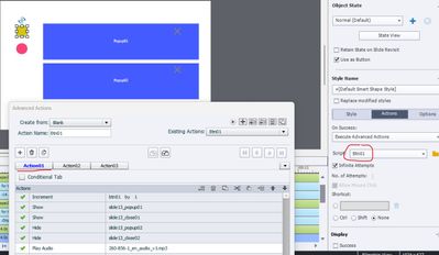

Yes, this question was posted for a different scenario where the popups didn't have a close button. Now the scenario is different with the popups having the closing button. The Action 03 on the btn 01 is just to show the red cross visible while on revisit so that learner doesnt have to wait for the audio to complete and then the orange arrow will turn in to red to close the popup. Can find it in the screenshot 05 below.
Timeline screenshot 
Please find the screenshot and mp4 explanation below.

You make it difficult to understand. Couple of tips to start with:
  • Never push the pausing point of a button to the end of the slide, you may get problems.  Leave a short duration after the pausing point. But they all need to be at the same time, except maybe for the Next button where the pausing point can be later.
  • Why is that slide duration increased beyond 3 seconds?  I suspect because you have also slide audio on that slide but the Timeline panel was not complete.  If that is indeed the case, you may have overlapping audio when the button is pressed before the slide audio has ended.
  • Please read this blog post and use the Preview window to take screenshots, much easier to understand the complete advanced action if you have multiple decisions. And to show which actions are triggered by which event, use the Advanced Interaction panel for a screenshot. It will take you much less work to provide all those screenshots. I think I have some understanding now, but that took quite a while.
    https://blog.lilybiri.com/advanced-actions-dialog-box-in-captivate-2017
  • You use Show/Hide instead of state changes, but would save lot of time if you also use grouping of the objects you need to hide/show.
  • I suppose that the 14 seconds are the duration of the audio clip triggered by 'Play Audio'?
