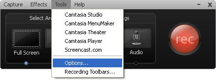

Ahhh okay, gotcha!
With Camtasia, you will want him to create a Flash based output. He will create either a .SWF or a .FLV file. You will then use the Insert > Animation (if SWF format) or Insert > Flash Video (if FLV format) to get the Camtasia output into Captivate.
I'm not sure about this next bit as the Camtasia rendering process may change the playing field a bit. But when he records, in the Camtasia recording settings, ensure he configures the Camtasia frame rate to 30 frames per second. That's the default frame rate for Captivate.
