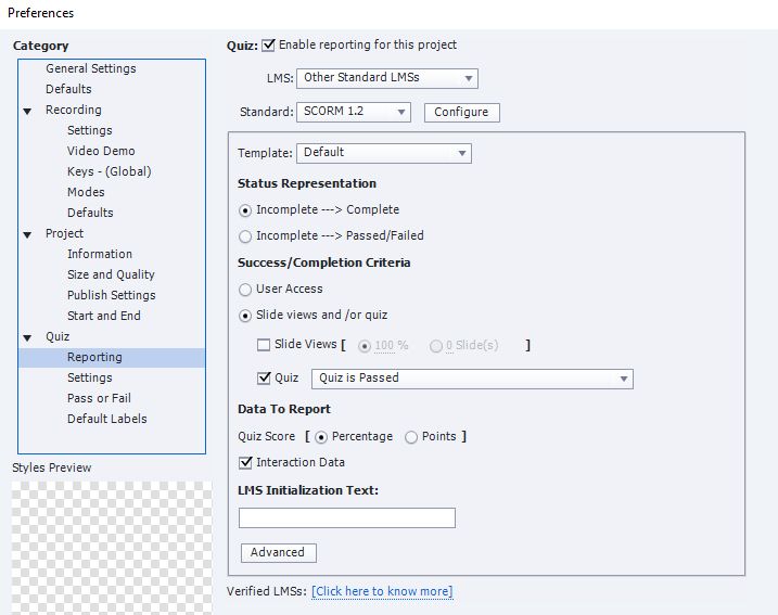

I am trying to upload my zipfile to our LMS. Gets the imsmanifest error.
I have read trough the forum and checked my reporting settings.
The imsmanifest file are located in the rootfolder. See attached images.
I do not would like to use reporting since I am using xAPI for the reporting but since I got the error I thought I needed to use reporting. I do not have any element in the project that reports so I guess that could be the problem. Any work around for this?
Thnx

Have no experience with xAPI reporting, but is available under Quiz, Reporting:

The only times I have seen this error are either because the user has not configured Quiz Reporting (which you have done) or else because you have simply zipped the entire folder in which the SCORM files were published and thought that this zip file would be accepted by your LMS.
Simply zipping the folder from the outside means that the imsmanifest.xml file is NOT in fact at the root level of the zip archive (even though it is at the root level of the folder inside the zip archive).  When the LMS unzips the SCORM it is NOT expecting to look for a manifest file inside a folder.  It's expecting to see the manifest file right there.
This is why it is always better to let Captivate create the SCORM zip by selecting the zip option in the Publish Settings.  Captivate creates this zip in the correct way by selecting all files INSIDE the folder and then zipping them, not from the OUTSIDE of the folder.
Is this possibly what has happened?
