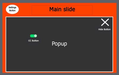

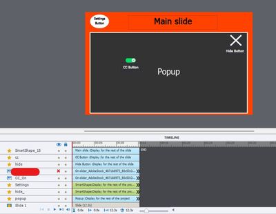

In my captivate project of 5 slides, on the Main slide, there is a settings button that is used to open a popup with a CC button & Hide button inside the popup.
The Settings button, Popup with the CC button, and Close button will be present throughout the course.
When the Settings button on the main slide is clicked, it should open the Popup in which the CC button & Close button are present, but by clicking the Settings button it will hide the Closed Captioning which is at the bottom of the slide in "GREEN COLOR".
The CC button is used to show & hide the Closed Captioning which is at the bottom of the slide in "GREEN COLOR".
When the CC button is turned ON it should turn ON the Closed Captioning, with the Closed Captioning ON if the Hide button is clicked it will hide the popup with the CC button & close button inside the popup, but the Closed Captioning should still be ON throughout the course.
When the CC button is turned OFF it should turn OFF the Closed Captioning, with the Closed Captioning OFF if the Hide button is clicked it will hide the popup with the CC button & close button inside the popup, but the Closed Captioning should still be OFF throughout the course.

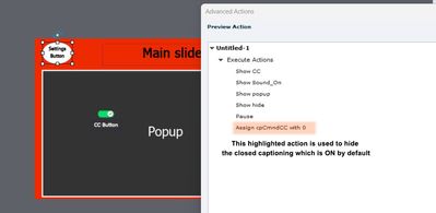

Can you show the Advanced Interaction panel with everything expanded for this slide? Make sure to be able to read the names of the interactions column.

Please I asked to make the column with the actions visible, it is the Success column. I see that you have 4 advanced or shared actions, but not what they are doing exactly. You seem to use 'CC' as label and use 'Hide' as name as wellfor a button? Please don't use that type of labels, you may bump on reservered key words. I wonder if you are not using the same name for the advanced actions, reason why I wanted to see them in the Success column.

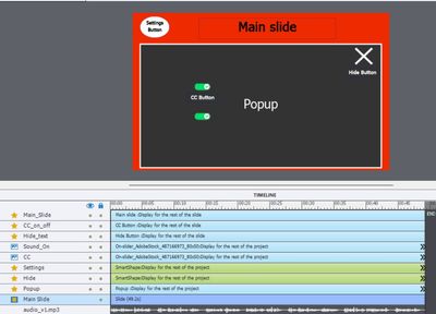

I would for sure group the 4 buttons because you show and hide them at the same time and if I'm correct from the Timeline they are timed for the rest of the project.

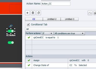

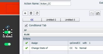

I see that the button CC has an added custom state, can I see the Object state panel for that button?
On the Timeline I don't see any button which is pausing the slide. What do you expect to happen when the last frame of the slide is reached?

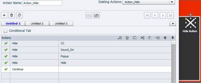

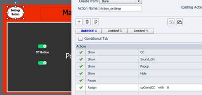

A column with the actions visible
Advanced actions for all the buttons
  • Settings: 
  • CC
  •   Hide
 Yes the buttons are timed for rest of the project.
  • Timeline
Object state panel of CC:
At the last frame of the slide the slide should stop playing.

I see that you have a Failure action for all the buttons, which means that you don't have Infinite Attempts for those buttons! Why did you limit the attempts? At least put that Failure action to 'No Action' instead of Continue.
How do you pause at the last frame? The On Exit event has No action, and that could pause the slide after the last frame. Do you have a button for that goal on the master slide to pause at the last frame?

If you want each slide to pause at its end, insert a shape button on the main master slide. Make it invisible bu setting both Alpha and Stroke to 0. It will automatically pause each slide at its end, whatever the duration, if you keep the default settings.  You only have to make sure that each used daughter master slide inherits the objects on the main master slide. I just hope this is a non-responsive project.
