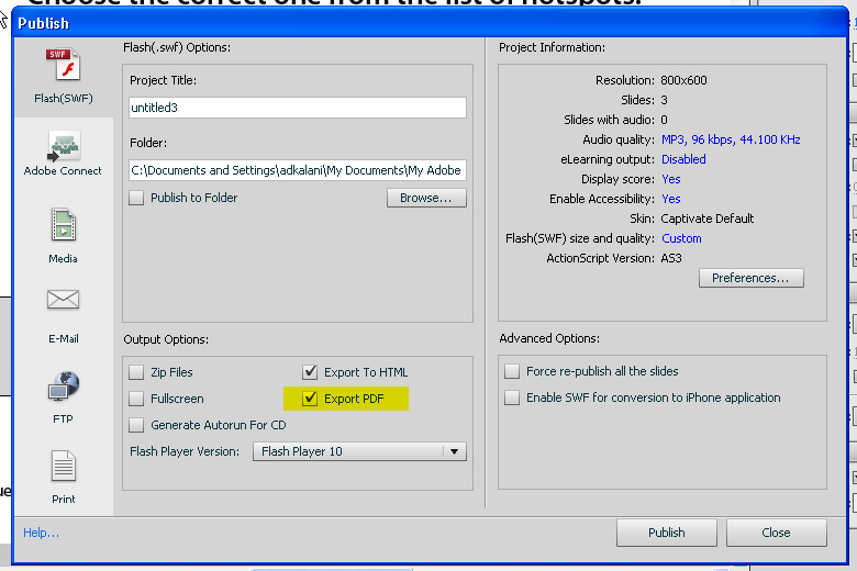

You can directly publish the project into PDF from Adobe Captivate.
Click on File menu - Publish.
in the publish dialog box, under output options, check 'Export PDF'
check screen shot for more information.
