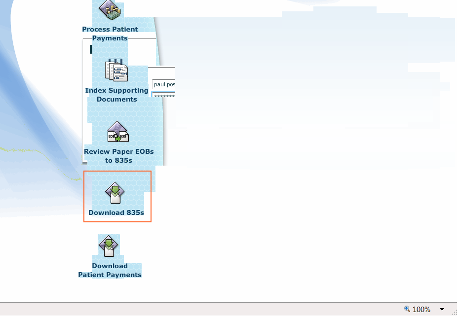

I am attaching a screen print to illustrate my issue.  I've had two others in my company on different computers that experience this exact same issue.  I was a bit surprised to not find more "complaints" about this online as, at least for me, it's more than just a random happening.   I am publishing to SWF and HTML5.

I brought up one of my projects that's been having this problem, was getting screen bleed thru in 2 different places when viewing in the preview or after publishing.  I turned off the Advanced Project Compression, saved the project, and that immediately resolved the issue.  The demo ran fine in both preview and after publishing with no bleed thru at all.  Assuming this resolves the issue now for me in all cases, it would seem that this option definitely has some bugs!  Thanks for the suggestion ElaKat!
