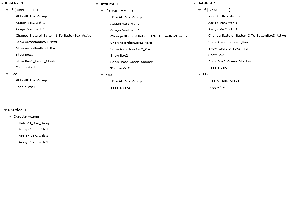

I managed to do some work over the weekend on my initial project and I've had some success with having each hidden object show when its button is clicked, hide when it's button is clicked again, hide others and show if another button is clicked and also hide all if anywhere else on the slide is clicked.
I'm in no doubt there are far more elegant solutions compared to what I have achieved, especially for scalability; for example if I decided to use this slide theme as a template on another project but increase the button/object count from 3 to 12, or anything in between.
In the meantime, while I aim to refine my current project and delve in to creating one based on the links you provided, I will post some screen shots of my initial project and if there is any pitfalls to what I've done or refinements I could make, please, if you can, offer some of your thoughts.  Your help is very much appreciated, more so as I'm aware your contribution to this portal is voluntary. (Cap is doffed)
Again, thank you for your time.  Have a great day!
- Paul
