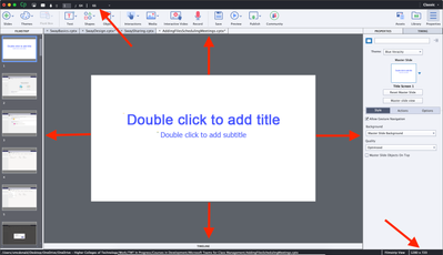

I'm having an odd problem that I've not had before. I have been creating simulations for a project at work - which I do often as it's what we use Captivate for most these days - and my recorded slides are much larger than the first and last slide that come by default when I start a new project, even though the project is set to 1280 x 720. I don't know what happened but I assume it's related somehow to something I did while recording...? It's never happened before but now it's on all five of the simulations I'm working on.
You can see in the shots below an example. The first slide, which is just there from the basic theme is at a view of 66 and size of 1280 x 720, and you can see how much space is around the stage. The second slide also has a view of 66 and is 1280 x720 but there is much less space around the stage. All of the project slides are like this except the first and last, which are the default with new project. The third slide is what it looks like in Captivate, while the fourth is the preview with everything cut off.

Looks to me like these more recent captures were not done at exactly the same screen resolution or Windows display percentage as the previous ones.  If that is correct, the only way to fix this so that everything looks seamless is to redo the simulations at the same settings as before.

You started in sort or a reversed way. If you want to do a capture which needs to end up to a specific resolution there are several ways:
  1. Start with the content slide (not captured) which will set the resolution of the final project and use the Slides, Recording option to start the capture. The resolution of the captured slides will automaticallybe set to the project size.
  2. Capture the simulation as you have done. To embed them in a project with a specific resolution, you use Modify, Rescale and get the resoltuion (mostly down) to what you need, while keeping the width/height ratio. The advantage of this workflow is that the result will be more crisp but the disadvantage is the bigger file size. If the final project has a different width/height ratio, you can use the approach which I explained in a recent blog/

If all of your captures belong to the same capture session then were they all captured at exactly the same dimensions (1280 x 720 height and width) as shown in your current project?  If you still have those capture CPTX files separate to your current project you should be able to open those CPTX files and take a look at what the measurements are.
If so, then it would appear that perhaps either the browser display percentage or the Windows 10 display percentage was different to what you did previously.  Either way something was different.
Captivate does allow you to use options under Modify > Rescale Project to change the dimensions of a project.  That would only be of use to you as a last resort (in my opinion) because making changes to captured screenshots that way will inevitably sacrifice the resolution of the final images.  They will likely look 'blurry' and not crisp.
