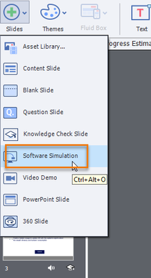

This is the Software Simulation option

Software simulation can be in several modes... still not sure what you used. And did you use the correct Preview method which is F11, Preview in Browser?
