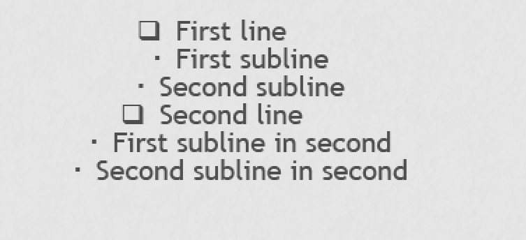

I am using Adobe 2017 ver. 10.0.1.285. When I launch "Preview Project" I have noticed the sub-bullets are aligning with the Main Bullet instead of being indented like the first sub-bullet. What is going on with the mis-aligning? I have verified the sub-bullets are aligned correctly in the project itself.

Can you post a screenshot? I rarely use bullets, don't like that word....
Explorer ,
Jun 06, 2018 Jun 06, 2018
Lilybiri,
The project is a responsive project. Thank you!

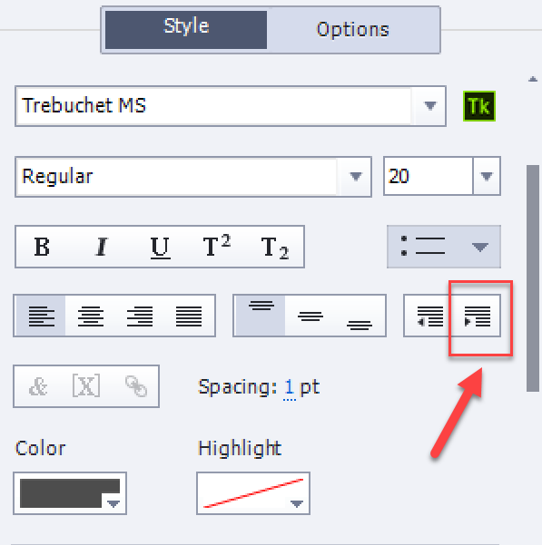

How do you create the sub-bullets? I use the Indent button:

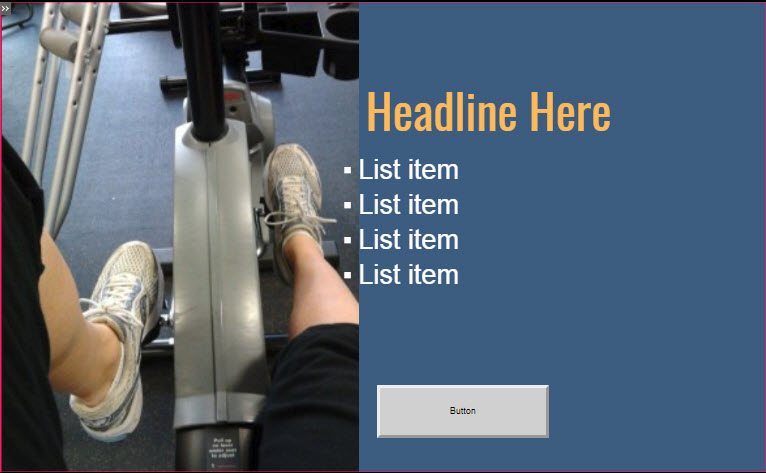

Curiously enough, I'm having a similar issue. I'm not using sub-bullets, but I am instead indenting a bullet set because I like its style better. It also goes with company branding.
I dummied up a slide to show an example...
This is what the slide looks like inside Captivate...Bullets-design mode.jpg
This is what it looks like in Preview mode...

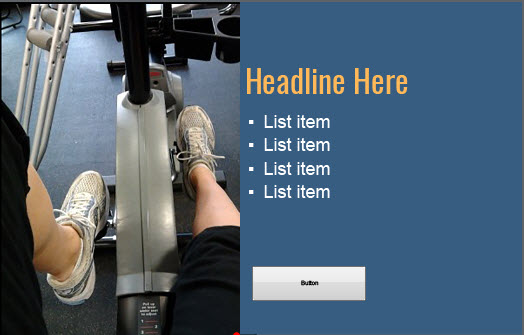

I copied and pasted the slide into a non-responsive project, and this is what it looks like in Preview mode...
Furthermore, when I upload the responsive project to our LMS, I get the same result as I do in Preview mode. (Second image above.)
I even tried using Arial, but I got the same results.
So, using my very basic understanding of the e-Learning world, it seems to have something to do with the combination of indenting and the responsive project.
