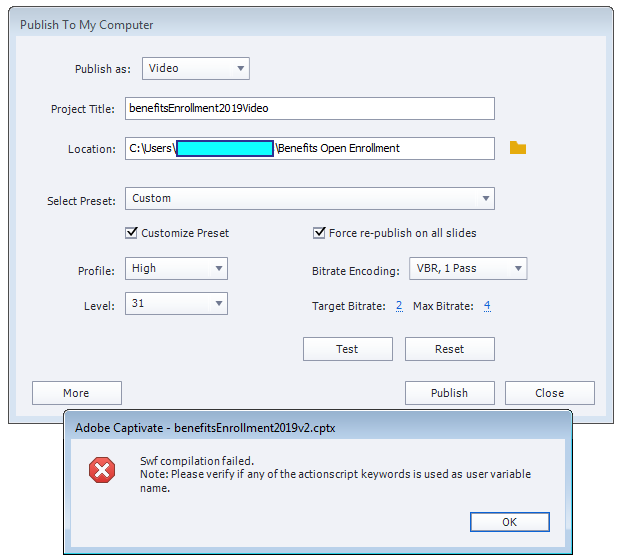

Participant ,
Sep 18, 2018 Sep 18, 2018
I'm having this issue when trying to publish a course as a video and cannot seem to resolve it with any of the steps. I've tried to implement the .ini file fix, but I get a "not authorized" error and cannot save changes to that file. I've tried running Captivate as administrator, I've tried hiding slides to see what slide/element might be causing the issue, and even with all hidden but a single blank slide at the beginning, it won't publish as video.
This is a course I need 2 versions of--one to run on AdobeConnect that has super-light interactivity (a couple of pauses), and one that needs to just run as a video on a public website. It publishes fine as an html5 course, but fails to publish every time as a video.
HELP! Is the only fix the Captivate 6 one? I'm running Captivate 2017 on Windows 7 Pro.

Ok, let me back up. I arrived at this post because I'm getting the same error message as the original poster. There doesn't seem to be a post addressing this common error specifically with a user trying to output mp4, and I don't understand the issue either!
Yes, I understand that the solution document I posted the link to was for an older version, but an Adobe staffer posted it as a solution in the thread we're conversing in right now, which references CP9 as the version in the OP. In this thread: SWF Compilation Failed CP 2017 , an Adobe staffer also posted the same link as the solution, even though the poster clearly stated that they were using CP 2017 and Windows 10. I've seen the link as an Adobe-recommended solution in one other post today, but I closed that window and don't still have the link. I think it was reasonable, given that this is Adobe's recommendation in at least three threads for the same error message, that I tried the steps they instruct users to take.
Here's what I'm looking at when I try to publish this as a video:
Yes, I tried that. I didn't find a specific slide causing the issue. In fact, when I had hidden all but the first slide and was still having the same issue, I dropped in a blank slide and hid everything else, and the error persists. In fact, that screen shot above is the result of trying to publish with just the one blank slide showing. It will publish html5 but throws this error at me when I try to publish as a video.
Participant ,
In fact, I just created a new blank project with three slides that each have just a line of text. I try publishing as video, and I get the same error.

That was one of the first things I tried when the issue came up yesterday, and I dumped it before opening the project this morning. I also went to the utils folder and ran CleanPreferencesWin.

No, I haven't tried that yet (and of course, I'd rather not have to go there!); but what about the clean project I started that does the same thing? That simply consists of three 3-second slides with a line of text on each one, and it behaved the same way. Am I just doing something wrong in the publish settings for Video? (I've unchecked "Enable reporting for this project" before publishing.) I'm no expert on these settings; I could certainly be doing something wrong there, but it is just not jumping out at me!
