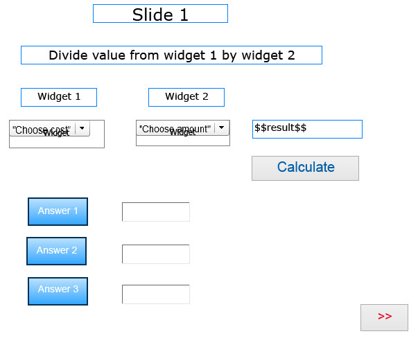

The first slide contains two widget with drop down values and a button which is used to divide the value of the first widget by the value in the second widget e.g. 200/10. The calculate  button is linked to advanced actions.
This works correctly the first time that I enter this slide. However, if I go onto the next slide but then come back to the first slide, it does not work.  Below is a sequence of images which shows this:
fig 1 - First option in widget 1 is "Choose cost" and in widget 2 is "Choose amount". The other values in the first widget are 200 and 400 and the values in the second widget are 10 and 20.

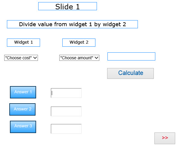

fig 4 - Now back on slide 1 again. This time I get a NaN error message. Despite the fact that the widgets are showing 400 and 10 respectively, the underlying values appear to be the text strings from the first options in the widgets i.e. "Choose cost" and "Choose amount" and this is why NaN has appeared in the result box.

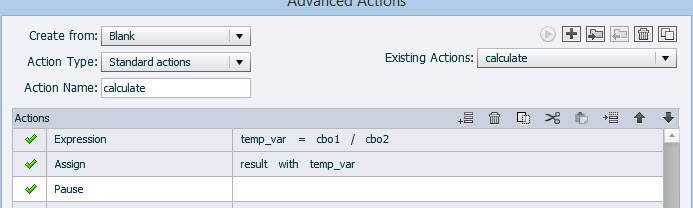

The captivate development screen looks like this:
drop_down8.jpg.
And the advanced action screen looks like this:
Would appreciate any thoughts on how to resolve this issue.

No need for the pause at all, any advanced action will never release the playhead.
I suppose cbo1 and cbo2 are the variables associated with the two dropdown interactions?  Why do you use two variables for the result: both temp_var and result? I don't see any reason.

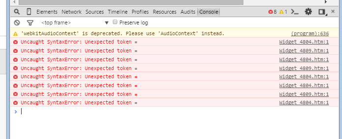

I have also just  run the project in Internet Explorer outside of Captivate. So this is not just a preview. Again, THE WIDGETS ARE NOT WORKING AS EXPECTED. The error console shows the following:
fig 2
Judging by this error message, the widgets don't appear to exist when I re-enter the slide after coming back from slide 2. The error is reported as occurring on line 1 of the widget files but these files appear to be OK. Here for example, is the file for Widget_4804.htm:

I've also run this in Firefox and found that the widgets ARE WORKING AS EXPECTED. However, there are lots of errors being thrown up in the console:
fig 3
I've now run this in Chrome and the widgets ARE WORKING AS EXPECTED. However, again the log files show that  errors are being generated which relate to the widgets. As you can see here:
fig 4.
Finally, I've run this in Safari and found that the widgets ARE NOT WORKING AS EXPECTED. Here is a screen shot of the error message that I got:
fig 5
To sum up then, the widgets work in 2/4 browsers but they are throwing up errors in all cases.
