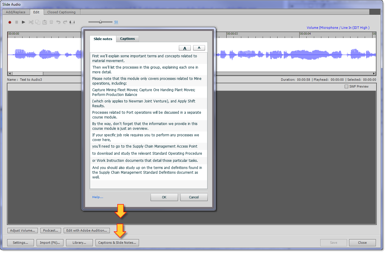

Once you are in the Slide Audio dialog, look for the button at the bottom that says: Captions and Slide Notes.
This allows you to view a panel containing your voiceover script in Slide Notes.  You can also enlarge the text to suit your taste...or your eyesight.

Got all that Rod, thanks.
My point was if the total length of the script notes for an individual slide is too large to display on a single screen (above), you get a scroll bar on the right side of Slide Notes pop-up. With Captivate v4, you would detach the slides notes window and expand it to make sure all your notes could be seen "as one".
I was concerned that now having to use a scroll bar when recording could create off stage noises....

Feb 06, 2012 Feb 06, 2012
Excellent....that was what I was missing and just what I need.
Many thanks - Excellent help as always.
